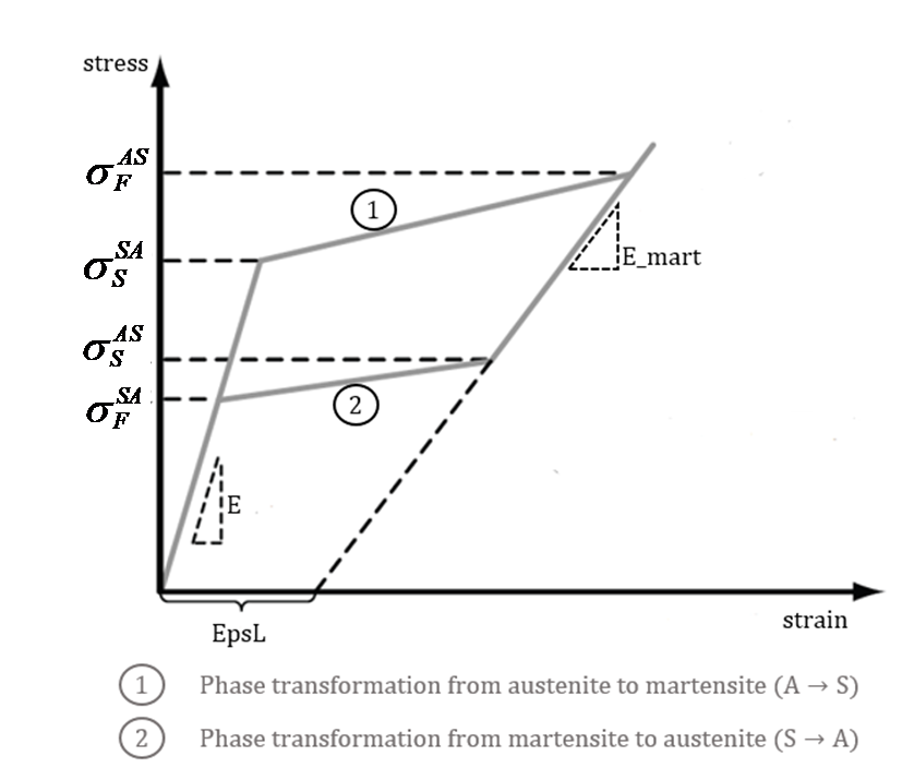

- If E_mart=0, then Young's modulus is considered constant, equal to E, and not dependent on the phase fraction of the material.
- The different stresses
and
, defining the start and the end of phase
transfomation, as well as the residual strain EpsL, correspond to the case
of a uniaxial tensile test:
Figure 1. - The parameter
