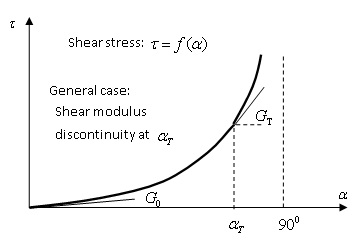

G0 Initial shear modulus.
Default = G, where G = G T 1 + tan 2 ( α T )
(Real)
[ Pa ]
GT Tangent shear modulus at α = α T .
(Real)
[ Pa ]
α T Shear locking angle.
(Real)
[ deg ]
Gsh Traverse shear modulus (only used with multi-layer property).
Default G s h = G 0 (Real)
If G0 = 0, then G s h = G T 1 + tan 2 ( α T )
[ Pa ]

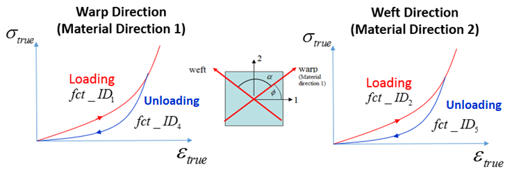

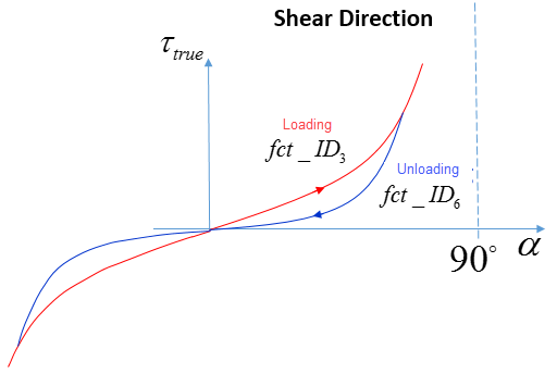

  3. Rules concerning input functions for the optional loading and unloading stress-strain curves.
    • All tabulated input curves must be monotonically increasing. Radioss Starter will output write an error message when the input is not monotonically increasingin case of wrong input.
    • Case without unloading (fct_ID4=fct_ID5=fct_ID6=0):
      All loading functions are optional. The user may use an analytical formula or define a loading function in any direction. Tabulated and analytical behavior may be mixed in any direction.
    • Case of loading / unloading with hysteresis with at least one unloading function is defined.
      • Loading functions tabulated input in are loading is mandatory in all directions. Functions fct_ID1, fct_ID2, and fct_ID3 must all be defined. It is not possible to mix analytical formulae in loading with unloading functions.
      • Not all unloading curves need to be defined. If an unloading curve is missing in any direction, the loading and unloading will take the same path with no hysteresis.
      • If loading and unloading functions are defined, they must have strictlyonly one intersection point to define the hysteresis loop. An error message is written in case on incorrect input. The exception is the shear functions are curves in shear which must have two intersection points for negative and positive values.
      • An error message is written when input is incorrect.
  4. Stress-strain relation in tension and compression in direction of fibres.
    • When nonlinear functions are used.
      fct_ID1, fct_ID2 define loading and fct_ID4, fct_ID5 unloading behavior

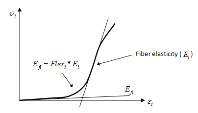

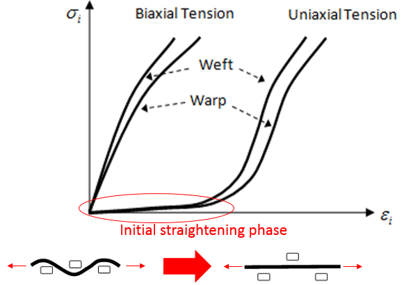

  5. Initial straightening effect of the woven fabric.
    This material allows you to account for the initial straightening effect of the woven fabric.
    law58_loading_phase
    • It is assumed to be softer in the tensile direction during the straightening phase. In biaxial tension there is no straightening phase and the fibers bear loads from the beginning of the loading phase.
      Use factor Flexi to scale the E modulus or function f i MathType@MTEF@5@5@+= feaagKart1ev2aqatCvAUfeBSjuyZL2yd9gzLbvyNv2CaerbuLwBLn hiov2DGi1BTfMBaeXatLxBI9gBaerbd9wDYLwzYbItLDharqqtubsr 4rNCHbGeaGqiVu0Je9sqqrpepC0xbbL8F4rqGqFfpeea0xe9vq=Jb9 vqpeea0xd9q8qiYRWxGi6xij=hbba9q8aq0=yq=He9q8qiLsFr0=vr 0=vr0db8meaabaqaciGacaGaaeqabaWaaeaaeaaakeaaciGGMbWaaS baaSqaaiaadMgaaeqaaaaa@396E@ (fct_ID1 or fct_ID2) in corresponding direction.
      f f t _ i = F l e x i f i MathType@MTEF@5@5@+= feaagKart1ev2aqatCvAUfeBSjuyZL2yd9gzLbvyNv2CaerbuLwBLn hiov2DGi1BTfMBaeXatLxBI9gBaerbd9wDYLwzYbItLDharqqtubsr 4rNCHbGeaGqiVu0Je9sqqrpepC0xbbL8F4rqGqFfpeea0xe9vq=Jb9 vqpeea0xd9q8qiYRWxGi6xij=hbba9q8aq0=yq=He9q8qiLsFr0=vr 0=vr0db8meaabaqaciGacaGaaeqabaWaaeaaeaaakeaaciGGMbWaaS baaSqaaiaadAgacaWG0bGaai4xaiaadMgaaeqaaOGaeyypa0JaamOr aiaadYgacaWGLbGaamiEamaaBaaaleaacaWGPbaabeaakiabgwSixl GacAgadaWgaaWcbaGaamyAaaqabaaaaa@465C@ (function input)
      E f t = F l e x i E i MathType@MTEF@5@5@+= feaagKart1ev2aqatCvAUfeBSjuyZL2yd9gzLbvyNv2CaerbuLwBLn hiov2DGi1BTfMBaeXatLxBI9gBaerbd9wDYLwzYbItLDharqqtubsr 4rNCHbGeaGqiVu0Je9sqqrpepC0xbbL8F4rqGqFfpeea0xe9vq=Jb9 vqpeea0xd9q8qiYRWxGi6xij=hbba9q8aq0=yq=He9q8qiLsFr0=vr 0=vr0db8meaabaqaciGacaGaaeqabaWaaeaaeaaakeaacaWGfbWaaS baaSqaaiaadAgacaWG0baabeaakiabg2da9iaadAeacaWGSbGaamyz aiaadIhadaWgaaWcbaGaamyAaaqabaGccqGHflY1caWGfbWaaSbaaS qaaiaadMgaaeqaaaaa@4447@ (parameter input)
      law58_straightening
      Figure 3.
      • If the value of Flex1 or Flex2 is equal to zero, then the value of Flex will be used.
      • The straightening portion of the strain is given by the strains S1 and S2 for direction 1 and 2 correspondingly.
      • The functions fct_ID1 and fct_ID2 correspond to biaxial tension, where the initial straightening is not taken into account. In uniaxial tension, the straightening effect is accounted for by using Flex1 and Flex2 in the stress calculation. It is similar to the case when E1 and E2 are specified instead of the curves.
    • In compression, the Young's modulus is always:
      E = F l e x i E i MathType@MTEF@5@5@+= feaagKart1ev2aqatCvAUfeBSjuyZL2yd9gzLbvyNv2CaerbuLwBLn hiov2DGi1BTfMBaeXatLxBI9gBaerbd9wDYLwzYbItLDharqqtubsr 4rNCHbGeaGqiVu0Je9sqqrpepC0xbbL8F4rqGqFfpeea0xe9vq=Jb9 vqpeea0xd9q8qiYRWxGi6xij=hbba9q8aq0=yq=He9q8qiLsFr0=vr 0=vr0db8meaabaqaciGacaGaaeqabaWaaeaaeaaakeaacaWGfbGaey ypa0JaamOraiaadYgacaWGLbGaamiEamaaBaaaleaacaWGPbaabeaa kiabgwSixlaadweadaWgaaWcbaGaamyAaaqabaaaaa@422D@

  6. Stress-strain relation in shear.
    • When tabulated input is present fct_ID3 is used for loading and fct_ID6 for unloading.
      • If fct_ID6 is not specified, the material is assumed to be hyperelastic, and the loading and unloading paths are the same.
      • If fct_ID6 is given, the material shows hysteresis behavior with different path for loading and unloading in shear directions.
      • The nonlinear functions (fct_ID3, fct_ID6) are not mandatory. If these functions are not specified, the corresponding values of G0, and GT are used to calculate the stress-strain relationship of the material.
      • For function fct_ID3, fct_ID6, which determine loading and unloading in shear the abscissa should be set in degrees. The functions should be specified both for negative and positive values of the angle (normally the functions are symmetrical).
      • Absolute value of the angle, and its value should be less than 90 degrees, | α | < 90 MathType@MTEF@5@5@+= feaagKart1ev2aqatCvAUfeBSjuyZL2yd9gzLbvyNv2CaerbuLwBLn hiov2DGi1BTfMBaeXatLxBI9gBaerbd9wDYLwzYbItLDharqqtubsr 4rNCHbGeaGqiVu0Je9sqqrpepC0xbbL8F4rqGqFfpeea0xe9vq=Jb9 vqpeea0xd9q8qiYRWxGi6xij=hbba9q8aq0=yq=He9q8qiLsFr0=vr 0=vr0db8meaabaqaciGacaGaaeqabaWaaeaaeaaakeaadaabdaqaai abeg7aHbGaay5bSlaawIa7aiabgYda8iaaiMdacaaIWaWaaWbaaSqa beaacqWIyiYBaaaaaa@4011@ .
      • Loading and unloading functions should pass through point (0,0). Loading and unloading curves should have exactly one intersection point for negative angle and another intersection point for positive angle.
        Figure 5.

    • When parameters are used to describe relation between shear stress and angle, two different shear situations could be described:
      • In plane (1 - 2) shear:
        Before shear locking angle α α T MathType@MTEF@5@5@+= feaagKart1ev2aqatCvAUfeBSjuyZL2yd9gzLbvyNv2CaerbuLwBLn hiov2DGi1BTfMBaeXatLxBI9gBaerbd9wDYLwzYbItLDharqqtubsr 4rNCHbGeaGqiVu0Je9sqqrpepC0xbbL8F4rqqrFfpeea0xe9Lq=Jc9 vqaqpepm0xbba9pwe9Q8fs0=yqaqpepae9pg0FirpepeKkFr0xfr=x fr=xb9adbaqaaeGaciGaaiaabeqaamaabaabaaGcbaGaeqySdeMaey izImQaeqySde2aaSbaaSqaaiaadsfaaeqaaaaa@3BEF@ :(3)
        τ = G 0 tan ( α ) τ 0 MathType@MTEF@5@5@+= feaagKart1ev2aqatCvAUfeBSjuyZL2yd9gzLbvyNv2CaerbuLwBLn hiov2DGi1BTfMBaeXatLxBI9gBaerbd9wDYLwzYbItLDharqqtubsr 4rNCHbGeaGqiVu0Je9sqqrpepC0xbbL8F4rqqrFfpeea0xe9Lq=Jc9 vqaqpepm0xbba9pwe9Q8fs0=yqaqpepae9pg0FirpepeKkFr0xfr=x fr=xb9adbaqaaeGaciGaaiaabeqaamaabaabaaGcbaGaeqiXdqNaey ypa0Jaam4ramaaBaaaleaacaaIWaaabeaakiGacshacaGGHbGaaiOB aiaacIcacqaHXoqycaGGPaGaeyOeI0IaeqiXdq3aaSbaaSqaaiaaic daaeqaaaaa@43DF@
        After shear locking angle α > α T MathType@MTEF@5@5@+= feaagKart1ev2aqatCvAUfeBSjuyZL2yd9gzLbvyNv2CaerbuLwBLn hiov2DGi1BTfMBaeXatLxBI9gBaerbd9wDYLwzYbItLDharqqtubsr 4rNCHbGeaGqiVu0Je9sqqrpepC0xbbL8F4rqqrFfpeea0xe9Lq=Jc9 vqaqpepm0xbba9pwe9Q8fs0=yqaqpepae9pg0FirpepeKkFr0xfr=x fr=xb9adbaqaaeGaciGaaiaabeqaamaabaabaaGcbaGaeqySdeMaey Opa4JaeqySde2aaSbaaSqaaiaadsfaaeqaaaaa@3B42@ :(4)
        τ = G tan ( α ) + G A τ 0 MathType@MTEF@5@5@+= feaagKart1ev2aqatCvAUfeBSjuyZL2yd9gzLbvyNv2CaerbuLwBLn hiov2DGi1BTfMBaeXatLxBI9gBaerbd9wDYLwzYbItLDharqqtubsr 4rNCHbGeaGqiVu0Je9sqqrpepC0xbbL8F4rqqrFfpeea0xe9Lq=Jc9 vqaqpepm0xbba9pwe9Q8fs0=yqaqpepae9pg0FirpepeKkFr0xfr=x fr=xb9adbaqaaeGaciGaaiaabeqaamaabaabaaGcbaGaeqiXdqNaey ypa0Jaam4raiGacshacaGGHbGaaiOBaiaacIcacqaHXoqycaGGPaGa ey4kaSIaam4ramaaBaaaleaacaWGbbaabeaakiabgkHiTiabes8a0n aaBaaaleaacaaIWaaabeaaaaa@4599@
        law58_shear
        Figure 6.
        Where,
        G A = ( G 0 G ) tan ( α T )
        τ 0 = G 0 tan ( α 0 )
        α T
        Shear locking angle
        GT
        Shear modulus at α T
        G0
        Shear modulus at α = α 0
      • If the G0 = 0, then its value is calculated to avoid discontinuity of the shear modulus at α T : G0 = G
      • The values of G0 and GT are ignored if the nonlinear functions (fct_ID3 and fct_ID6) are specified. However, the values G0 is still required to calculate the prestress from the reference geometry and evaluate material stiffness used in contact. In such cases, G0 should correspond to average stiffness (average slope) of the corresponding loading functions.
      • α T is an initial complementary angle, which is equal to the difference between 90 degrees and the initial angle between the anisotropy axes defined in the shell property (/PROP/TYPE16 (SH_FABR)).
