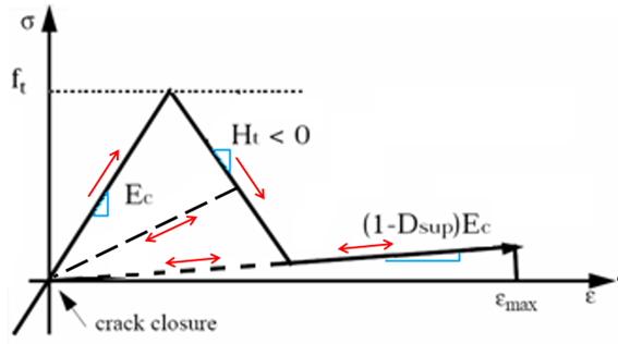

- The parameters for the damage model
are:

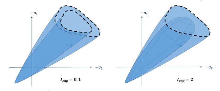

Figure 1. Stress Strain Curve for LAW24 Damage Model. meridians of failure and yield surfacesWhere, is the uniaxial compression strength.

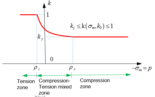

Figure 2. Scale factor shapes the yield surface from the failure surface- For
Icap
=0 or 1:

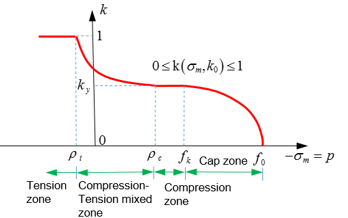

Figure 3. - For
Icap
=2 (with cap):
Figure 4.

- There is no cap effect when because there is no compaction. The default values of dilatancy parameters and were modified for Icap = 0 or 2 in Radioss 2017. These parameters should be negative with recommended values of -0.2 and -0.1, respectively. The default cap formulation was updated in Radioss 2017. To enable the original cap formulation used in Radioss 14.0 and older, set Icap = 1. The Icap =2 formulation is more accurate for triaxial and hydrostatic loadings. The cap hardening is a function of the compaction coefficient. The shear hardening modulus is reduced in the transition region which assures better stability. Icap = 2 must be used to output plastic strain using /ANIM/BRICK/EPSP or /H3D/SOLID/EPSP.

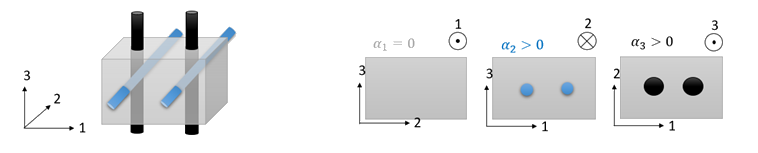

- The embedded rebar model is optional. It
uses an elastic-plastic with hardening material
model. When defining rebar section fractions, a
homogenized behavior is assumed for each element.
The element should be large enough to stand for a
Representative Elementary Volume (REV). This
homogenized model is mostly used with large
structures and a coarse mesh. Otherwise, rebar can
be modeled with trusses, springs, beams, or even
brick elements. the section ratio of rebars must
be provided
, and
Figure 5. - The rebar directions must be defined in the orthotropic solid property /PROP/TYPE6. Otherwise, the local element coordinate r, s, and t are taken respectively as directions 1, 2, and 3; unless Isolid = 1 or 2 is used with Iframe = 2; in which case the orthotropic directions 1, 2 and 3 are defined with the local co-rotating element coordinate r, s, and t, when time = 0.
- In an axisymmetrical analysis, direction 3 is the direction.
