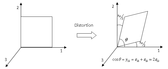

- Stress-strain relation in
elastic phase.The stresses and strains are related as:
(1) (2) (3) (4) Where,- Strains
- Stresses
- , and
- Distortions in the corresponding material directions
