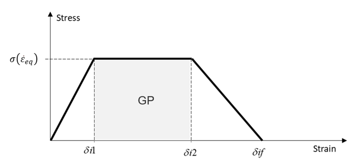

Comments
- The elastic stiffness is
defined with:
Figure 1.Where,- GP
- Plastic energy under constant stress
- GC
- Total energy
- ={I,II}
- The mode I (normal) and mode II (shear)
The shape of the traction separation law is defined with:- Failure criteria
defined by ratio of fracture energy
(Ifail_i=1)
(1) - Failure criteria
defined by ratio fracture displacements
(Ifail_i=2)
(2)

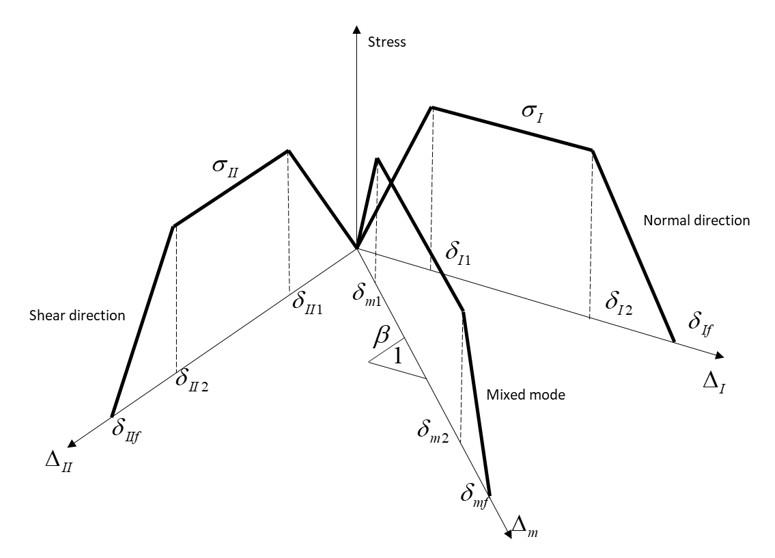

- Yield stress and damage law
scheme:
Figure 2. - For yield and damage based
on quadratic nominal stress (Icrit=1):
- Mixed-mode yield initiation
displacement is:
(7) Where,- ={I,II}, the mode I and mode II.
- Mixed-mode damage
initiation is:
(8) Where,- ={I,II}, the mode I and mode II.
displacement is:
on quadratic nominal stress (Icrit=2).
displacement is:If :
(9) If :(10) Where,- Displacement is mode I (normal).
- Displacement is mode II (shear).
- Mixed-mode damage
initiation is:If :
(11) If :(12)
displacement is:
- The mixed-mode final damage
is (Icrit=1,2):
(13) Where,- Displacement is mixed mode.
