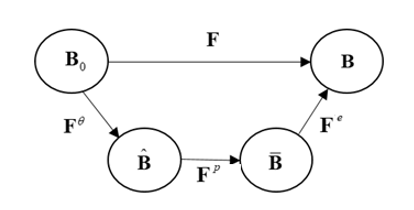

Figure 1. Decomposition of the total deformation gradientThe description of the kinematics of the problem is based on the decomposition of the deformation gradient into elastic, viscoplastic, and isotropic thermal components.(1) - The model considers the
