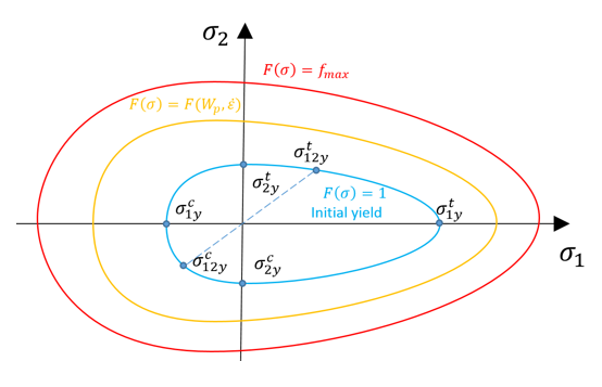

Tsai-Wu Yield Criteria for Iform=0 and =1
- Iform=0: Tsai-Wu
- Iform=1: CRASURV

- Interaction coefficients
- Iform = 0: Tsai-Wu
- Iform = 1: CRASURV
- The default reduction factor, , is typically used.

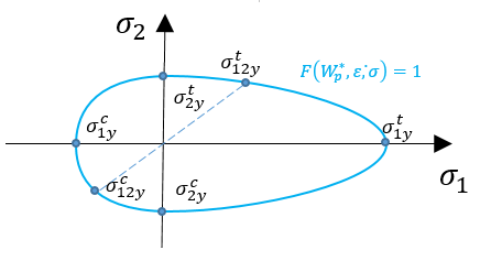

- With
- Here
- Material in elastic phase, if
- Material in nonlinear phase, if
- The yield stress limit is in range of 1 and
