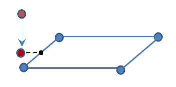

The heat exchange is computed from main to secondary and from secondary to main:(11) - By default,
Iproj
=1 is used to avoid having the wrong mass distribution when
the secondary node is projected outside of the main element. The mass and
inertia are distributed on the closest edge based on the projection of the
secondary node on this edge. Use
Iproj
=2, to obtain the same results as Radioss version 14.0 or older.
Figure 1. - When using the penalty formulation Spotflag=25, moments cannot be transmitted from the secondary nodes to a main segment. Therefore, it is not recommended to use it for any connection where the secondary nodes have rotational degrees of freedom. This would include: shell to shell, spring to shell, shell to solid where the shell is secondary and solid is main. Due to this limitation and the lower robustness compared to kinematic formulations, it is recommended to use the mixed kinematic and penalty formulation, Spotflag =27 and 28.
