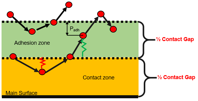

- IVIS2=-1: is used to add
adhesion in the normal direction and viscous resistive forces in the tangential
direction. This can be used to model thermoplastic composite forming.When used, half of the contact gap is considered an adhesive zone and the other half a physical contact zone. Therefore, to maintain the same physical contact gap, the contact thickness should be doubled using Gap_scale.
Figure 10.The adhesive force is only applied after secondary nodes have entered the physical contact zone and then move back into the adhesion zone. The adhesive force acts to prevent the node from moving out of the adhesion zone and is applied in the normal direction.(11) Where,- Area of the secondary surface
- Penetration into the adhesion zone
- Contact gap as calculated in Comment 3
The adhesive spring ruptures as the node exits the adhesion zone and will be recreated if the node enters the contact zone again.
Viscous resistive forces are applied in the tangential direction when the secondary nodes enter into the adhesion zone. A viscous tangential opposing force is applied instead of a friction force and is calculated as:(12) Where,- Area of the secondary surface
- Contact gap
