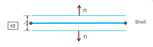

If the surface is defined with shells, two contact segments (shifted by half thickness (t)) with opposite normal directions will be generated:
Figure 1.In case of SPMD, each main segment defined by surf_IDi (i=1, 2) must be associated to an element (possibly to a void element).

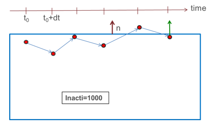

- Inacti = 1000:
The initial penetrations are ignored: no contact force is applied, but
the nodes are not deactivated from the contact; if the node goes out of
the contact and later gets back into contact, contact forces are then
applied.
Figure 2. - Inacti = -1: Initial forces are applied on all penetrating nodes. High initial penetrations should be avoided, as they might generate high contact forces and lead to high energy error at the beginning of the computation. The contact forces caused by the initial penetration are increased from zero at the contact activation time defined by Tstart or sens_ID to a maximum value Tpressfit after contact activation. The ramping of the contact forced caused by initial penetration allows for press fit situations in models to be simulated. To avoid dynamic effects, Tpressfit should not be too small. By default Tpressfit is the time corresponding to 10000 cycles.

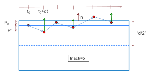

- Inacti = 5: The main segment is shifted by the initial penetration value ( ); therefore, at time zero no initial forces are applied.
The main segment position is restored only in case of rebound larger than .
In the opposite case, when secondary node continues to penetrate, the penetration is computed as:(7)
Figure 3.- Intersections and large initial penetration (Inacti= -1 and

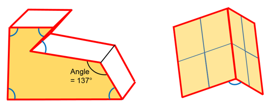

- When edge to edge contact is
activated using
=1, the edge to edge contact is
symmetric and the edges used in contact are automatically generated from the
defined single surface (surf_ID1) or surface to surface contact
(surf_ID1 and surf_ID2):
- For solids and shells
The edges are considered anywhere the angle between two external segments which share the same edge is smaller than Edge_angle value (by default 135°).
- For shellsThe edges are considered at the perimeter border of the shell parts.
Figure 6.
