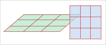

Figure 1. - With Irem_gap = 2, it allows to have the element size smaller than gap values:

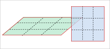

Figure 2. Secondary nodes removed from node to surface contact
Figure 3. Secondary lines removed from edge to edge contactIn case of self-impact contact, when Curvilinear is smaller than (in initial configuration), then this secondary entity (node / line) will not be taken into account by this main entity (surface / line). The secondary entity will not be deleted from the contact for other other main entities. This also applies both nodes to surface and edge to edge contact as stated in the /INTER/TYPE7 and /INTER/TYPE11 comments.

- Edges to edge contact flag Iedge:
- Iedge = 1: only external
edges are generated from contact surfaces which defined by SHELL parts, it is
recommended for optimized performance. Cannot be used when the surface contains only
solid parts which lead to an empty line and then error message will be printed.
Figure 4. - Iedge = 2: all edges are
generated from contact surfaces.
Figure 5.
