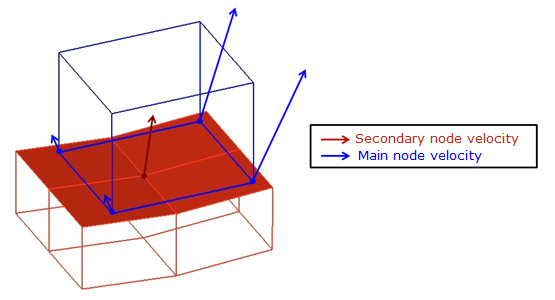

Block Format Keyword Interface TYPE12 described fluid to fluid contact and enables the transmission of flow between two ALE surfaces (main and secondary side). The secondary node velocities are interpolated from main surface values. Then convective fluxes are calculated between the two surfaces.

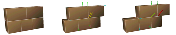

- ITIED flag sets the connection formulation.
- If ITIED = 0 (free)The algorithm continuously searches for a main segment neighbor corresponding to each secondary node. The node does not need to lie in the segment plane. This is the general case.
Figure 2. - If ITIED = 1 (tied)The neighbor search is performed initially and the grid velocity is then computed to keep the secondary node on its initial main segment.

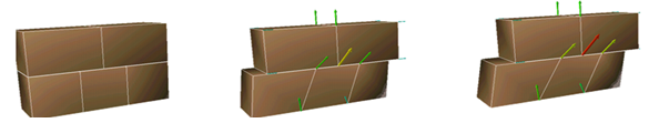

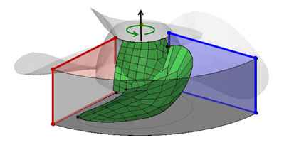

Figure 3. - If ITIED = 2 (periodic)A transformation matrix (translation and rotation defined from lines 6 to 8) is applied to the secondary nodes. Neighbors are then searched as for option ITIED =1. This allows communication between two faces of one or two different domains to reproduce angular periodicity: all material exiting from one side is injected on the other side after rotation.
Figure 4. - If ITIED = 3 (no convection)
