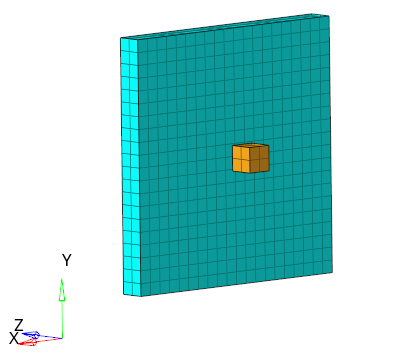

The plate is 254 mm square and 25.4 mm thick. The cube length is 25.4mm. The parts are modeled using solid elements and linear elastic material. An initial velocity of 5080 mm/s is applied to the block in the z direction. There are no other constraints in the model.

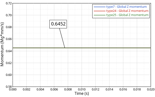

The global momentum can be plotted from the time history output. Figure 2 shows that the global z momentum for all interface models exactly matches the theoretical momentum of 0.6452 .
Figure 2. Global model Z momentum

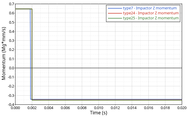

Figure 3. Impactor Z momentum

The global z momentum in the model exactly matches the theoretical momentum of 0.6452 Mg*mm/s.
