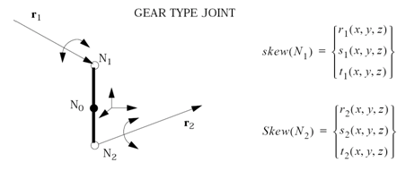

Figure 1. - Translational velocities of gear joint
nodes are constrained by a rigid link relation. For the rotational DOF, a scale
factor is imposed between velocities of node_ID1 and node_ID2, measured in their local coordinates. The
corresponding constraint equations are:
(1) (2) (3) (4) (5) Where, and are relative rotational velocities of node_ID1 and node_ID2 with respect to the rigid body rotational velocity.

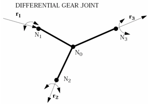

Figure 2. - The rotational velocities of a
differential gear joint are constrained by the relations:
(6) (7) (8)

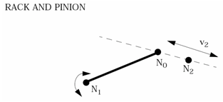

Figure 3. - The rack and pinion joint allows the
rotational velocity of node_ID1 to be transformed to a translational
velocity of node_ID2. The constraint equations for these
velocities are:
(9) (10) (11) - The node_ID3 is only necessary for a differential gear joint.
