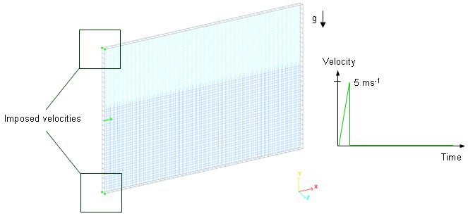

Velocities (/IMPVEL) are imposed on the left corners in the X direction.
Table 1. Imposed Velocity versus Time Curve
Velocity (ms-1) 0 5 0 0
Time (ms) 0 12 12.01 50
rad_ex_fig_6-4
Figure 1. Kinematic Condition: Imposed Velocities

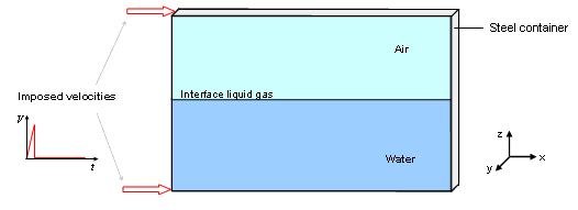

A rectangular tank made of steel is partially filled with water, the remainder being supplemented by air. The initial distribution pressure is known and supposed homogeneous. The tank container dimensions are 460 mm x 300 mm x 10 mm, with thickness being at 2 mm.
Deformation of the tank container is generated by an impulse made on the left corners of the tank for analyzing the fluid-structure coupling.
rad_ex_6-1
Figure 2. Problem Description

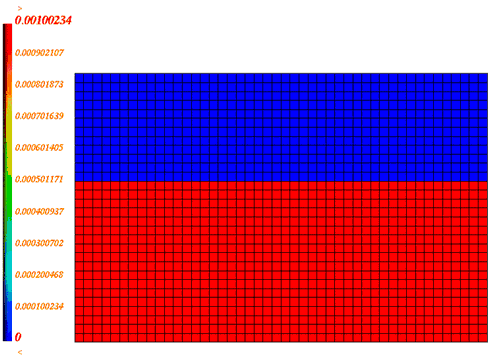

Model Method
Air and water are modeled using the ALE formulation and the bi-material law (/MAT/LAW37). The tank container uses a Lagrangian formulation and an elasto-plastic material law (/MAT/LAW2).
rad_ex_fig_6-8
Figure 3. Air and Water Mesh (ALE brick elements)

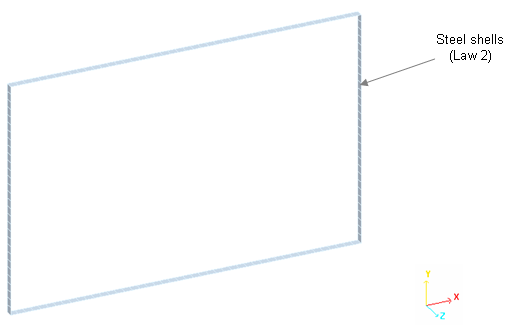

rad_ex_fig_6-3
Figure 4. Tank Container Mesh (shell elements)
Using the ALE formulation, the brick mesh is only deformed by tank deformation the water flowing through the mesh. The Lagrangian shell nodes still coincide with the material points and the elements deform with the material: this is known as a Lagrangian mesh. For the ALE mesh, nodes on the boundaries are fixed in order to remain on the border, while the interior nodes are moved.

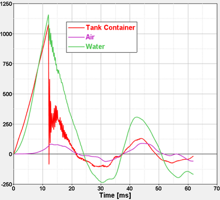

ex6_x_momentum_variation
Figure 5. X-Momentum Variation for Each Part
Kinematic conditions generate oscillations of the structure.

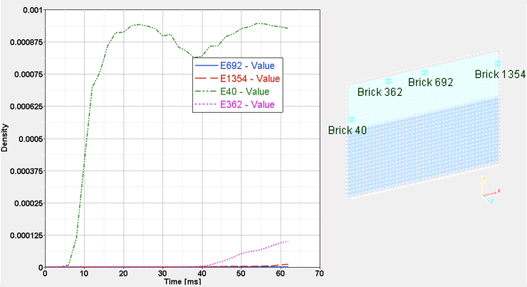

ex6_density_attached_variation
Figure 6. Density Attached to the Various Brick Elements

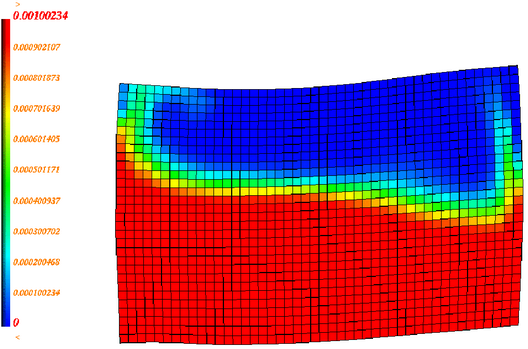

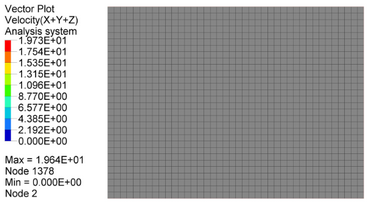

Table 2. Fluid Structure Coupling - Time = 0 ms
Density
density-0_zoom66
Velocity
velocity-0_zoom61

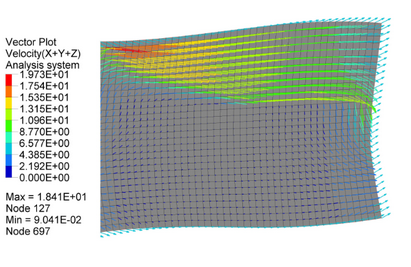

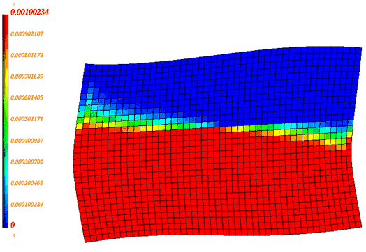

Table 3. Fluid Structure Coupling - Time = 12 ms
Density
density-12_zoom64
Velocity
velocity-12_zoom62

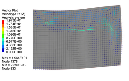

Table 4. Fluid Structure Coupling - Time = 42 ms
Density
density-42_zoom55
Velocity
velocity-42_zoom62
