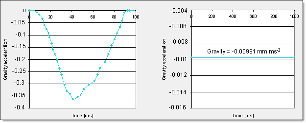

A function defines gravity acceleration in the X direction compared with time in order to simulate the rotation effect. Gravity is activated by /GRAV. Two cases are studied depending on the acceleration function selected:
ex6-fig9and10
Figure 1. Left: Variable Acceleration Function 1; Right: Constant Acceleration Function 2
Gravity is considered for all nodes.

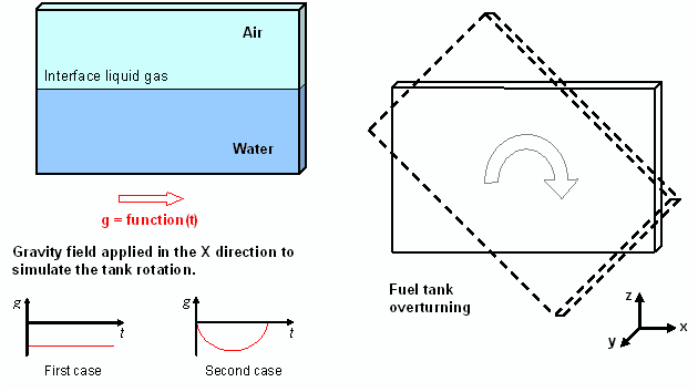

A rectangular tank is partially filled with water, the remainder being supplemented by air. The tank turns once around itself on the Y-axis. The overturning is achieved by defining a gravity field in the X direction, which is parallel to the liquid gas interface. All gravity is applied in other directions. The initial distribution pressure is already known and supposed homogeneous. The tank dimensions are 460 mm x 300 mm x 10 mm.
rad_ex_fig_6-7
Figure 2. Problem Description
The example deals with two loading cases: an instantaneous rotation of the fuel tank by 90 degrees (gravity function 1) and a progressive rotation (gravity function 2).

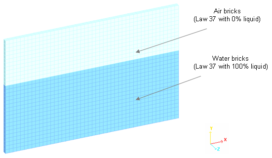

This loading case does not require a tank container mesh and the model, air and water are only comprised of the brick element using an ALE formulation.
rad_ex_fig_6-8
Figure 3. Air and Water Mesh (ALE bricks)
Using the ALE formulation, brick mesh is only deformed by the tank deformation, the water flowing through the mesh. The Lagrangian shell nodes still coincide with the material points, while the elements are deformed with the material: this is the Lagrangian mesh. For the ALE mesh, nodes on boundaries are fixed to remain on the border, while the interior nodes are moved.

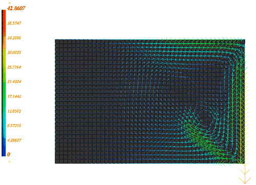

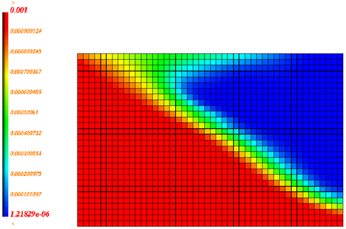

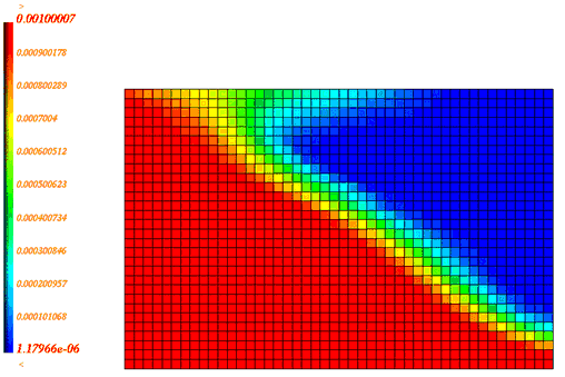

Results
Curves and Animations

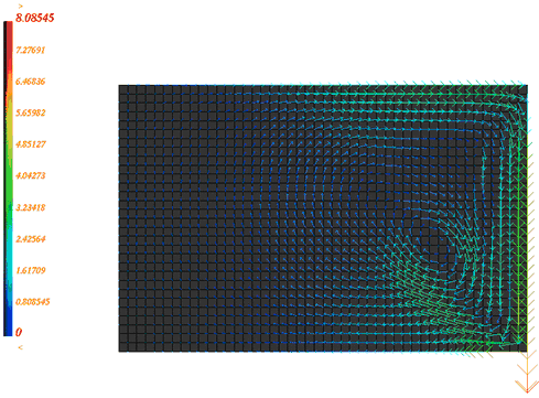

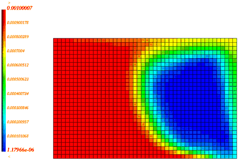

Table 1. Model with Constant Acceleration (Gravity function 1) - Time = 170 ms
Density
ex6_density-170_zoom53
Velocity
velocity-50_zoom59
Table 2. Model with Constant Acceleration (Gravity function 1) - Time = 280 ms
Density
ex6_density-280_zoom59
Velocity
velocity-70_zoom59

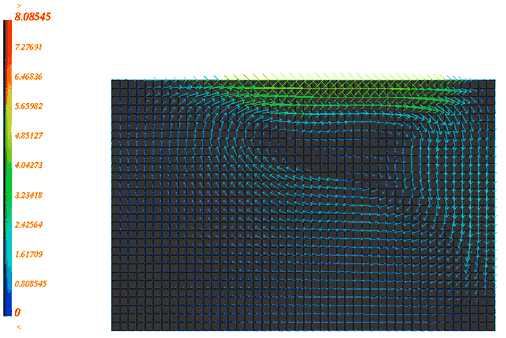

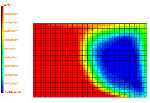

Table 3. Model with Variable Acceleration(Gravity function 2) - Time = 50 ms
Density
ex6_density-50_zoom62
Velocity
velocity-170_zoom61
Table 4. Model with Variable Acceleration (Gravity function 2) - Time = 70 ms
Density
ex6_density-70_zoom61
Velocity
velocity-280_zoom59
Conclusion
This example studied hydrodynamic bi-material using LAW37 in Radioss, using ALE and Eulerian formulations. The application of boundary conditions in ALE formations and handling the fluid-structure interaction were discussed. Furthermore, the results obtained correctly represent the physical problem.
