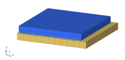

The contact friction forces are studied between a fixed and moving plate. The friction and reaction forces are used to calculate a displacement which is compared to the applied displacement.

Model Description
Total Displacement | ||
565 mm/s | 0.009 s | Y=2.54 mm |
-102 mm/s | 0.001 s | Z=0.0508 mm |
The following system is used: mm, s, Mg.

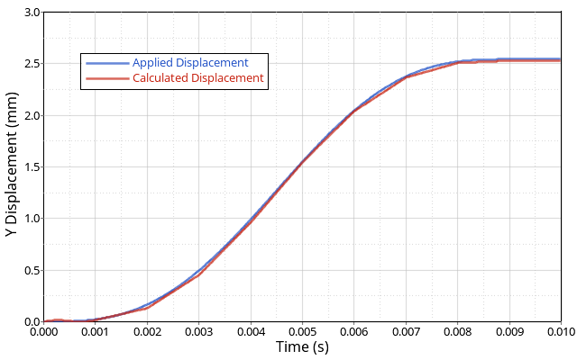

Figure 2. Applied Displacement and the Displacement Calculated
The calculated displacement, where the imposed velocity was applied in the y direction was 2.530 mm. When compared to the applied 2.540 mm displacement, there was a numerical error of 0.39%.
Conclusion
The contact interface friction calculation results in minimal error of 0.39% when compared to theory.
