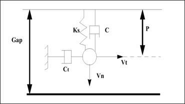

Several friction formulations are available within Radioss. The simplest one, which is also the most used, is the Coulomb friction law. This
formulation provides accurate results in crash analysis and requires just one
parameter (Coulomb friction coefficient, ). Figure 1. Normal and Tangential Forces Applied to a Node Figure 2. Adhesion Force Computation
The default value for is 0 (no friction between surfaces). To compute the
friction force, the default friction penalty formulation is a viscous one, based on
the tangential velocity. During sliding penetrate the node goes from position
C0 (contact point at time
t) to C1
(contact position at time ). As the contact is viscous, a viscous coefficient
C is introduced to compute the adhesion
force:(1)
Where,
K
Instantaneous interface stiffness
VISF
Critical damping coefficient on interface friction
M
Main node mass
Once the adhesion force (Fh) is computed, if it is less
than , the friction force is unchanged equaling
Fh and sticking will occur. If
the adhesion force is greater than , then the friction force is reduced and equals .(2)

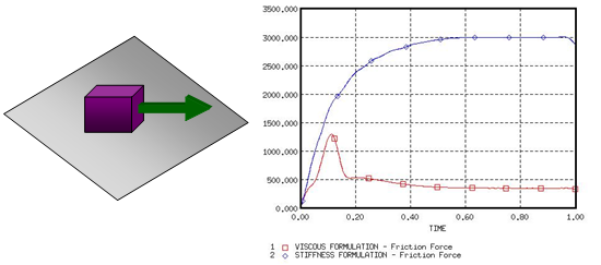

If sliding occurs at a very low speed (for example: quasi-static simulation), the
viscous formulation will not work, as the friction force is computed upon the
tangential speed. To overcome this limitation, a new friction penalty formulation is
available based on tangential displacement (stiffness incremental formulation). This
method introduces an artificial stiffness, K to calculate the
variation of the friction force:(3)
Where,
Tangent displacement
Therefore, contrary to the previous formulation, the stiffness formulation is able to
compute the proper friction force even at a low speed. Figure 4
illustrates this point. If an imposed displacement is applied to a part (a 3D cube)
at a low speed (0.01 m/s), the viscous formulation will not work; whereas the
stiffness formulation based on the tangential displacement will. Figure 4. Viscous Formulation versus Stiffness Formulation
