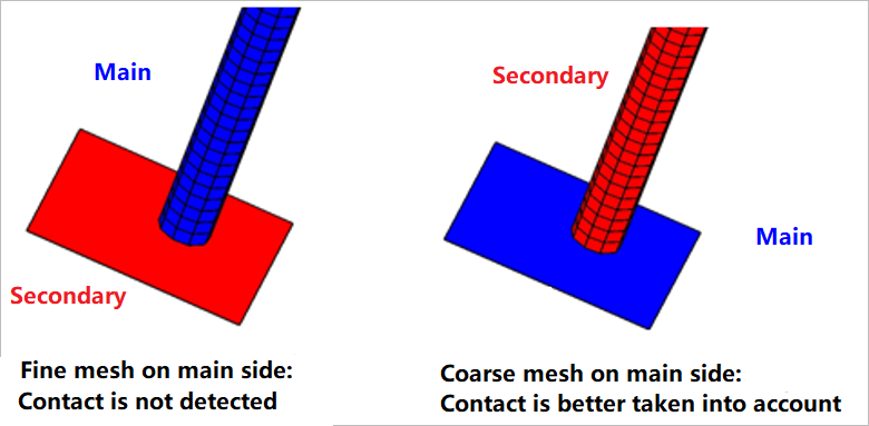

How to chose the main and secondary.
If the contact is neither self-impacting nor symmetric, then it is recommended to choose the coarse mesh on the main side for better contact detection. If the contact is self-impacting or symmetric, then it does not matter because all the elements and nodes will be both main and secondary.
In the following example, contact is not detected if the fine mesh is chosen on the main side.
In case both meshes are of the same size, the stiffer structure on the main side should generally be chosen.

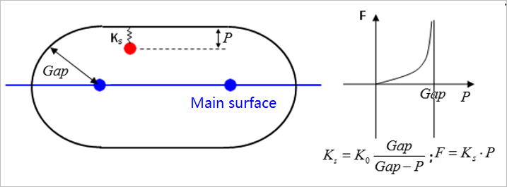

Initial contact stiffness
The initial stiffness K0 (that is to say the stiffness when the node enters the gap), computed by Radioss takes into account either both main and secondary stiffness (Istf =2 to 5) or only main stiffness (old way corresponding to Istf =0).
The stiffness is computed according to geometrical and material characteristics of the elements on main side and/or on secondary side (depending on the value of Istf).

The interface stiffness during the simularion is a nonlinear function of the penetration p and goes to an infinite value when the secondary node gets very close to the main segment in order to prevent the node from crossing the main segment and hence, better represent contact.
