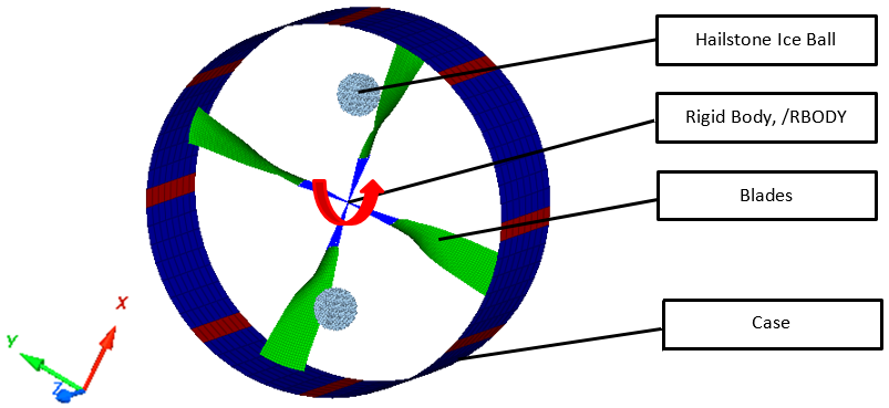

Four fan blades are rotating at 1000 RPM in a steady state condition inside a simplified case. The base of each blade is attached to a rigid body which is constrained in all directions except rotation about the z axis. The rotating blades impact two 3.07 kg hailstone ice balls which cause the blades to fail and then impact the case. The blades are assumed to be made of titanium with a constant 5mm thickness. The case is made of steel with varying thickness.
Figure 1. Blades with Case and Hail Ice Balls

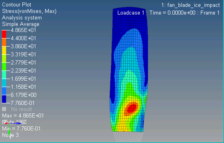

Figure 2, shows the blade stress at t=0.0 and that the initial pre-load stress in the state file was correctly included in the simulation.
Figure 2. Initial Stress on Blade at t=0.0

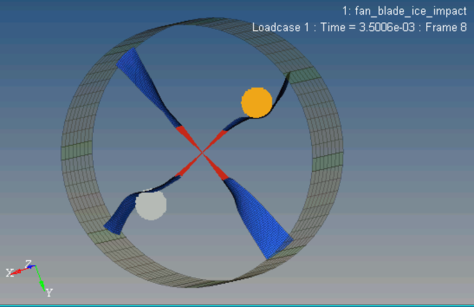

Figure 3. Initial Impact, t=3.5e-3

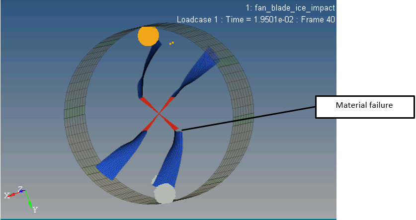

Figure 4. Blade Material Failure

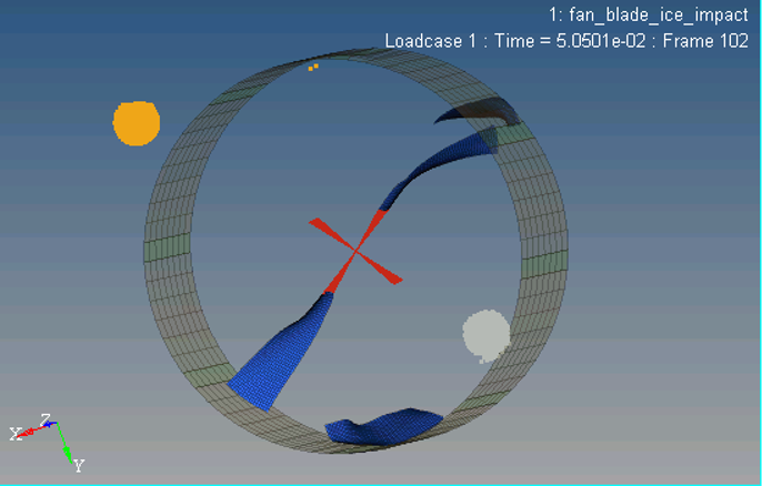

Figure 5. Blade Failure and Case Impact
