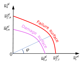

- A combined energy failure criteria is
defined as:
Figure 1.Where, and are the plastic displacement in the normal and tangential directions.
Damage of element begins when the damage surface is reached which is described by:(1) Where, and are the function of fct_ID0N and fct_ID0S. If there are no rate effects, the curves will be constant.
The damage factor is computed as:(2) And the stress is reduced as:(3) The element is deleted when the rupture surface is reached:(4) Where, and are the function of fct_IDFN and fct_IDFS. If there are no rate effects, the curves will be constant.
.Where, is the angle between the normal of the lower surface and the normal of the upper surface of the solid element.

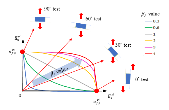

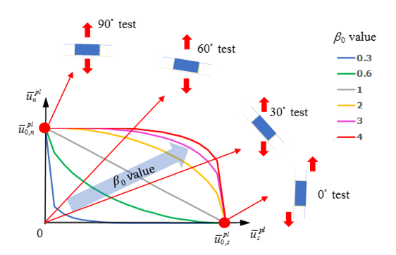

- Parameters
are fitted using a test which combines normal and shear
loards (30° test, 45° test or 60° test, etc.). At least one combined test is needed to
fit the parameters
. Figure 3 and Figure 4
show the effect of
on damage initiation and failure in combined test.
Figure 3. Displacement at damage initiation
Figure 4. Displacement at failure
