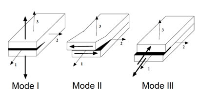

Coupling factor between
delamination Mode I and Mode II.
Default = 0 (Real)
delamination Mode I and Mode III.
Default = 0 (Real)
Yield energy damage for
delamination start.
Default = 1030 (Real)
Critical energy damage
parameter for full delamination.
For Quad 2D element, only Mode II
and Mode III are available.
Where, is the internal damage parameters associated
with its fracture mode.
