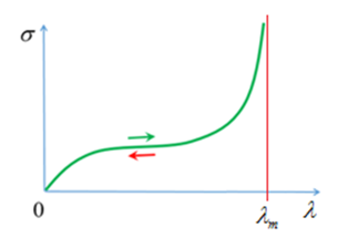

Defines the limit of stretch
Also called locking stretch. It specifies the
beginning of the hardening phase in tension (locking strain
in tension). Default = 7.0.
Figure 1. Locking Stretch

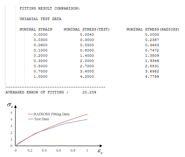

Poisson's Ratio and Material Incompressibility
If function input is defined, then parameters are ignored and Radioss
will calculate the material constant by fitting the input function. A nonlinear
least squares algorithm is used to fit the Arruda-Boyce parameters by Radioss. The curve fitting is performed using the assumption
that Poisson’s value is close to 0.5, which means the material is incompressible.
Similar to the other hyperelastic material models, Poisson ratio values closer to
0.5 result in high bulk modulus and a lower timestep. For a good balance between
incompressibility and a reasonable timestep, a Poisson’s ratio value of 0.495 is
recommended.
The material fitting information can be found in the Starter output file
(*0000.out). Figure 5. LAW92 function example

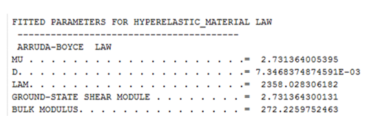

The fitting error and fitted material parameters are printed in the Starter output
file. Figure 6.
