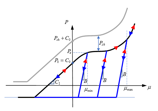

Comments
- This equation of state is used to model pressure in porous media such as soil or
foam. The compaction has an elastic response when it is less than the elastic limit
Figure 1. - Plastic compaction is along path
defined by curve:
(1) Where,- Pressure in material
- Volumetric strain with
Unloading and reloading are made along straight line whose slope is B.- Psh
- Pressure shift value used to model the relative pressure formulation.
Figure 2. Pressure versus Volumetric Strain - In versions prior to 2019.1, this equation of state was embedded in /MAT/LAW10 with a fixed elastic limit, .
