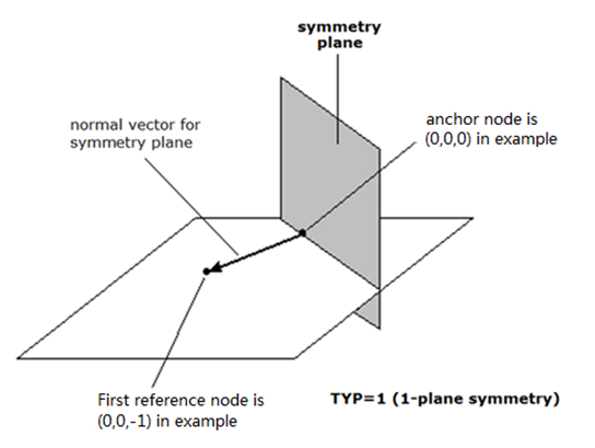

Figure 3.
/DTPL/1
grpart 1 for topology optimization
### MEMBSIZ=1: active member size control
### DRAW=1: active draw/casting direction constraint
### MMOCID=1: active Skew identifier flag for mapping the design domains in Multi-Model Optimization
### minimum diameter of members MINDIM=40 and maximum diameter of members MAXDIM=80
### TYP= 1: 1-plane symmetry
### Normal vector is from Anchor node (XA,YA,ZA) to First node (XF,YF,ZF)
### MCID=1: Skew identifier 1 used for mapping the design domains in Multi-Model Optimization
#grpart_ID TMIN STRESS MEMBSIZ PATRN PATREP EXTR MESH DRAW MMOCID
1 1 1 1
# MINDIM MAXDIM MINGAP
40 80
# TYP AID XA YA ZA
1 0 0 0
# FID XF YF ZF
0 0 -1
# UCYC SID XS YS
# MCID
1

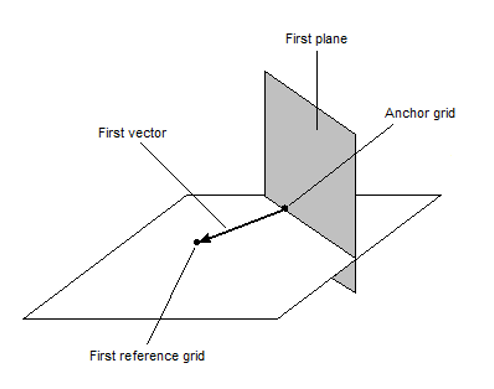

(active pattern), there are five pattern grouping options. This type of pattern grouping requires the anchor point and first point to be defined. A vector from the anchor point to the first point is normal to the plane of symmetry.
Figure 4. 1-plane symmetry (TYP = 1)This type of pattern grouping requires the anchor point, first point, and second point to be defined. A vector from the anchor point to the first point is normal to the first plane of symmetry. The second point is projected normally onto the first plane of symmetry. A vector from the anchor point to this projected point is normal to the second plane of symmetry.

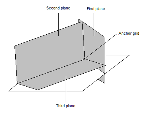

Figure 5. 2-plane symmetry (TYP = 2)This type of pattern grouping requires the anchor point, first point, and second point to be defined. A vector from the anchor point to the first point is normal to the first plane of symmetry. The second point is projected normally onto the first plane of symmetry. A vector from the anchor point to this projected point is normal to the second plane of symmetry. The third plane of symmetry is orthogonal to both the first and second planes of symmetry, passing through the anchor point.

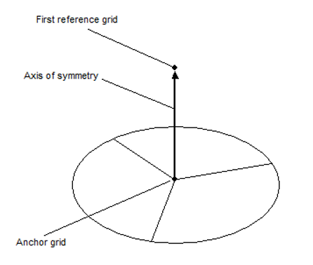

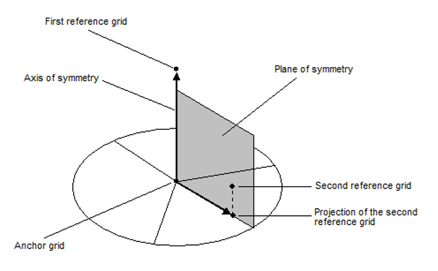

Figure 6. 3-plane symmetry (TYP = 3)This type of pattern grouping requires the anchor point, first point, and number of cyclical repetitions to be defined. A vector from the anchor point to the first point defines the axis of symmetry.
Figure 7. Cyclic (TYP = 10)This type of pattern grouping requires the anchor point, first point, second point, and number of cyclical repetitions to be defined. A vector from the anchor point to the first point defines the axis of symmetry. The anchor point, first point, and second point all lay on a plane of symmetry. A plane of symmetry lies at the center of each cyclical repetition.
Figure 8. Cyclic with symmetry (TYP = 11)For a more detailed description, refer to Pattern Grouping contained within the Topology Optimization Manufacturability section of the User Guide.

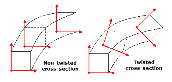

- EXTRU =1,
read the extrusion constraint definition. There are two types of extrusion
constraints: ETYP=0 (non-twisted cross-section) and
ETYP =1 (twisted
cross-section).
Figure 9.For a more detailed description, refer to Extrusion Constraints.

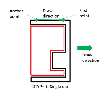

- DRAW =1,
read draw direction constraint definition. The type of draw direction that
could be used is single die (DTYP
=1).
Figure 10.For a more detailed description, refer to Draw Direction Constraints.
