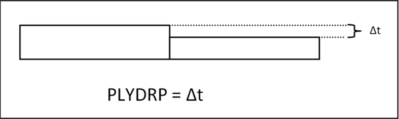

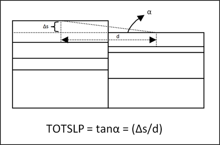

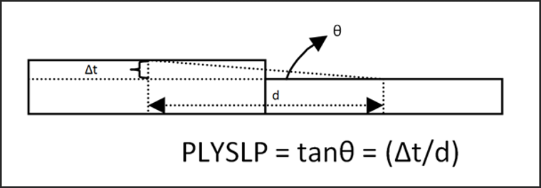

| PDANGLE | Ply orientation in degrees
to which the ply drop-off constraint is applied
(CTYP =
7). (Real) |
| PDTYP | Drop-off constraint type:
2
(Integer) |
| PDMAX | Maximum allowed drop-off
for the ply drop-off constraint (CTYP =
7). (Real) |
| PDEXC | Indicates that certain
plies are excluded from the ply drop-off constraint
(CTYP = 7). Supported
options are:
(Integer) |

- The options for selecting the type
of drop-off constraints for PDTYP are defined for a set of
plies.The PDTYP options are:
- PLYSLP
- PLYDRP
- TOTSLP
- TOTDRP
Figure 1.Assuming that the plies are stacked as shown above, the following definition is:
