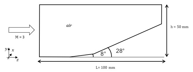

A supersonic wind tunnel (100mm length, 50 mm height) is filled with a supersonic
flow Machine number (M=3) of air.
The lower wall includes two wedges of 8 degrees and 28 degrees.
The two wedges slow the flow down with the formation of shock waves. Figure 2. Problem Description for Double Oblique Shock

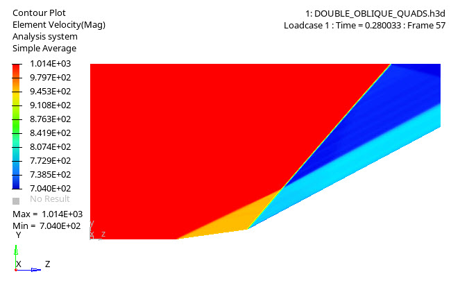

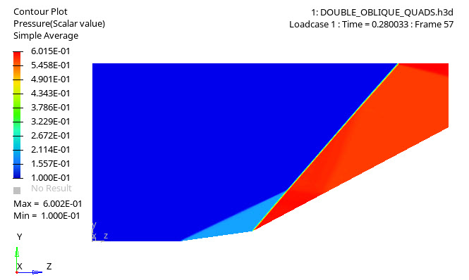

It is interesting to take a look at pressure element velocity and density once
steady-state is reached. Figure 4. Contour for Elemental Velocity Figure 5. Contour for Elemental Pressure

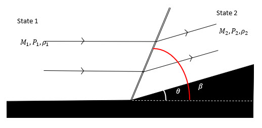

The shocks are created by the two wedges. These two obstacles slow down and
recompress the flow as it changes direction and becomes parallel to the wedge. With
supersonic flows, this process happens through an oblique shock wave, a stationary
discontinuity which separates a pre-shock state (State 1), where the fluid is in
this problem moving along the z-axis, from a post-shock state (State 2), with
increased pressure and mass density, but a lower velocity, as well as a new
direction, parallel to the wedge. Figure 8. Deflection of Supersonic Flow through an Oblique
Shock
The theoretical values of thermodynamic quantities in every state can be determined
analytically.
First, determine the angle of the shock , from the flow Mach number and the wedge angle , by solving:(7)

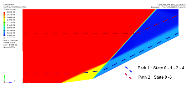

Numerical results for the thermodynamic variables can be read by drawing two node
paths along two current lines, one close to the wall and going through State 1, 2
and 4, and the other further away from the wall, going from State 0 to State 3
(Figure 9).
To draw node paths, the elemental results visible on the animation have to be
averaged at the nodes, using for example the averaging method simple.

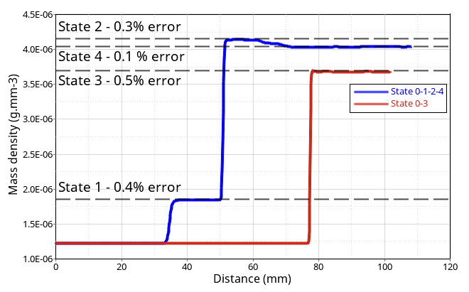

The spatial profile for pressure and mass density on these two nodes paths are
visible on Figure 10 and Figure 11. Each flat on the curves corresponds to one
the flow states described above. The value of the thermodynamic quantities obtained
from the model can then be compared to those determined analytically. Figure 10. Pressure Profile in Steady-State. with the value of the relative error to the analytical value Figure 11. Mass Density Spatial Profile in Steady-State. with the value of the relative error to the analytical value
