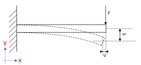

This example's purpose is to compare different modeling methods for a simple cantilever beam in terms of quality and performance.
A cantilever beam is fixed on the left end and a concentrated load is applied on the right side of the beam.
fig_28-4
Figure 2. Cantilever Beam with Single Load at the Beam End

Load case
Fx = 0
Fy = -1000.0
Fz = 0
For the linear problem, the analytical solution gives:(1) w= F L 3 3EI MathType@MTEF@5@5@+= feaagKart1ev2aaatCvAUfeBSjuyZL2yd9gzLbvyNv2CaerbuLwBLn hiov2DGi1BTfMBaeXatLxBI9gBaerbd9wDYLwzYbItLDharqqtubsr 4rNCHbGeaGqiVu0Je9sqqrpepC0xbbL8F4rqqrFfpeea0xe9Lq=Jc9 vqaqpepm0xbba9pwe9Q8fs0=yqaqpepae9pg0FirpepeKkFr0xfr=x fr=xb9adbaqaaeGaciGaaiaabeqaamaabaabaaGcbaGaam4Daiabg2 da9maalaaabaGaamOraiaadYeadaahaaWcbeqaaiaaiodaaaaakeaa caaIZaGaamyraiaadMeaaaaaaa@3CED@
Where,
F MathType@MTEF@5@5@+= feaagKart1ev2aaatCvAUfeBSjuyZL2yd9gzLbvyNv2CaerbuLwBLn hiov2DGi1BTfMBaeXatLxBI9gBaerbd9wDYLwzYbItLDharqqtubsr 4rNCHbGeaGqiVu0Je9sqqrpepC0xbbL8F4rqqrFfpeea0xe9Lq=Jc9 vqaqpepm0xbba9pwe9Q8fs0=yqaqpepae9pg0FirpepeKkFr0xfr=x fr=xb9adbaqaaeGaciGaaiaabeqaamaabaabaaGcbaGaamOraaaa@36C1@
Force
L MathType@MTEF@5@5@+= feaagKart1ev2aaatCvAUfeBSjuyZL2yd9gzLbvyNv2CaerbuLwBLn hiov2DGi1BTfMBaeXatLxBI9gBaerbd9wDYLwzYbItLDharqqtubsr 4rNCHbGeaGqiVu0Je9sqqrpepC0xbbL8F4rqqrFfpeea0xe9Lq=Jc9 vqaqpepm0xbba9pwe9Q8fs0=yqaqpepae9pg0FirpepeKkFr0xfr=x fr=xb9adbaqaaeGaciGaaiaabeqaamaabaabaaGcbaGaamOraaaa@36C1@
Length of the beam
E MathType@MTEF@5@5@+= feaagKart1ev2aaatCvAUfeBSjuyZL2yd9gzLbvyNv2CaerbuLwBLn hiov2DGi1BTfMBaeXatLxBI9gBaerbd9wDYLwzYbItLDharqqtubsr 4rNCHbGeaGqiVu0Je9sqqrpepC0xbbL8F4rqqrFfpeea0xe9Lq=Jc9 vqaqpepm0xbba9pwe9Q8fs0=yqaqpepae9pg0FirpepeKkFr0xfr=x fr=xb9adbaqaaeGaciGaaiaabeqaamaabaabaaGcbaGaamOraaaa@36C1@
Young's modulus
I MathType@MTEF@5@5@+= feaagKart1ev2aaatCvAUfeBSjuyZL2yd9gzLbvyNv2CaerbuLwBLn hiov2DGi1BTfMBaeXatLxBI9gBaerbd9wDYLwzYbItLDharqqtubsr 4rNCHbGeaGqiVu0Je9sqqrpepC0xbbL8F4rqqrFfpeea0xe9Lq=Jc9 vqaqpepm0xbba9pwe9Q8fs0=yqaqpepae9pg0FirpepeKkFr0xfr=x fr=xb9adbaqaaeGaciGaaiaabeqaamaabaabaaGcbaGaamOraaaa@36C1@
Moment of inertia
The theoretical deflection is determined to w = 13.07 mm.

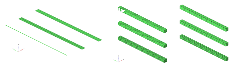

The beam is modeled with five different elements:
  • /BEAM
  • /SHELL
  • /BRICK
  • /TETRA4
  • /TETRA10
Figure 3. Different Meshes

For shell elements (/PROP/TYPE1 (SHELL)), several element formulations (Q4-shell with Ishell = 1, 2, 3, 4) are used. The results of modeling with QBAT-shell (Ishell = 12) and QEPH-shell (Ishell = 24) are compared.
For the solid mesh, the HA8 formulation (/PROP/TYPE14 (SOLID)) (Isolid = 14, 17, 18 and 24) are investigated. No reduced pressure integration is necessary for implicit computation, as the behavior is elastic (Icpre = 0).
For Tetra4 elements the formulations Itetra4 = 1, 1000 are used and for Tetra10 elements the formulations Itetra10 = 2, 100 are used.
