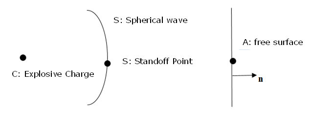

- Standoff point defined with
(Xs,
Ys,
Zs) is the location where the incident
pressure wave is given at time t=0:
Figure 1. - A plane wave can be simulated using a spherical wave and putting the explosive charge far enough away.

If in kg, in meter, in MPa and in ms.α TNT 52.12 1.180 0.0895 -0.185 PETN 56.21 1.194 0.0860 -0.257 HBX 53.51 1.144 0.0920 -0.247 - A free surface is a plane defined by a point and its normal vector.

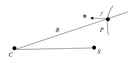

- The afterflow normal velocity is
calculated as:
(4) - P
- Fluid point.
- C
- Explosive charge point.
- S
- Standoff point.
