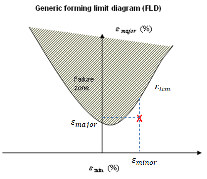

(5) - FLD failure (/FAIL/FLD)
(6)
Where,- Strain limit from FLD function
Figure 1.- BAO-XUE-Wierzbicki failure (/FAIL/WIERZBICKI)
