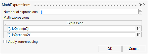

MathExpressions
The output of this block is a vector obtained by evaluating the mathematical expressions specified as block parameters. The expressions are given in terms of variables u1,...un where ui is the ith entry of the unique input vector used by all of the expressions.
MathOperations
The output of this block is a vector obtained by evaluating the mathematical expressions specified as block parameters, each expression corresponds to an element of the resulting vector. The expressions are given in terms of variables u1,...un where ui is the i-th entry of the unique input vector used by all the expressions.
Only double data type is allowed. Supported syntax is listed as following

work | Workspace evaluation | |||
nexx | Number of expressions | Number | ||
Exp | Math expressions: | Structure | ||
Exp/exx | Expression | Cell of strings | ||
zc | Apply zero-crossing | Scalar | 0 |
