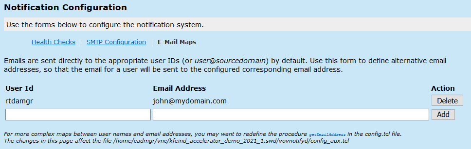

In some environments, the user name that is used to login to Monitor is not used as the user's email address. For these situations, fill in the User email map page with user name to email address mappings. This page is also available on the notification drop-down menu:
Figure 3. Email Map Page
