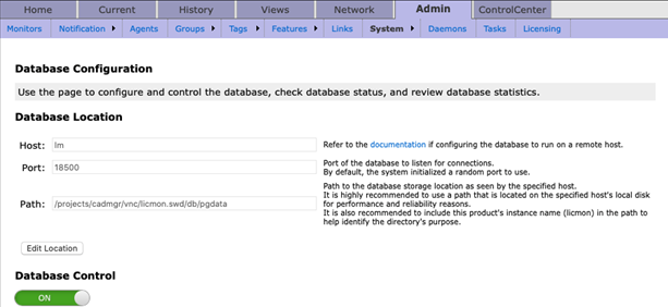

Database Information
You can use the System page to configure and control the database, check database status and review statistics.
Figure 2. System Database Configuration
You can edit the path to the database storage location as seen by the specified host.
We highly recommend that you use a path that is located on the specified host's local disk for performance and reliability reasons.
We also recommend that you include this product's instance name (licmon_yb) in the path to help identify the directory's purpose.
