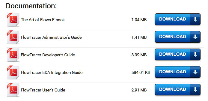

Types of Downloads Available
Documentation Files
The Documentation directory contains the PDF product help files for all the products. They are available to download.
The The Art of Flows by Andrea Casotto and Timothy Barnes is available as a free ebook download here. This book is the definitive explanation about the dynamics of managing a complex job mix such as ones used in the chip design process. Files, programs, and their dependencies are the fundamental issues for scheduling and deploying jobs in any design-oriented activity. This volume explains the importance of the problem, and how best to solve it.
This book is highly recommended as a practical guide to the value of using Altair Accelerator products with its clear introduction to dependency graphs and the importance of run time discovery of input and output files.
