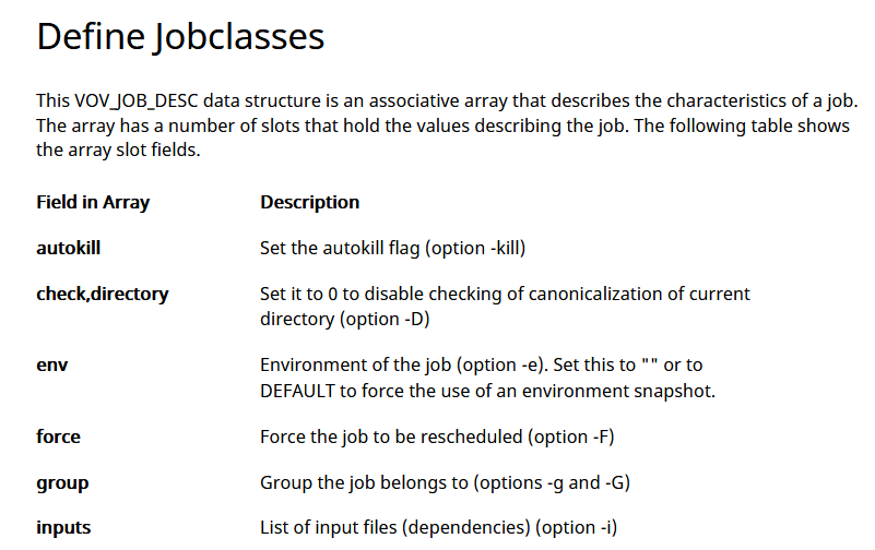

To view available job launch options, find the VOV_JOB_DESC table of options in the Jobclasses chapter of the Altair Accelerator Administrator Guide. Here is an excerpt of that table:
Although the above document has good descriptions of the fields/keys that can be provided to job launch requests, some of those fields are usable in Accelerator jobclass definitions but not in REST job requests. To see the precise list of fields/keys that are supported in REST requests, see the Swagger docs described in the REST Request Detailed Documentation section later in this tutorial.
You can modify the nc_run.py script previously shown (or the nc_run2.py script in an upcoming section) with additional options specified as key-value pairs in the VOV_JOB_DESC Python dictionary. For example, here is the modification to nc_run.py that specifies an auto-kill time of 60 seconds. The Python dictionary “update” method function provides a convenient way to do that.
