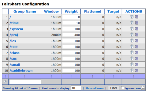

Set FairShare Weights Via the Web Interface
Accelerator Admins can change the FairShare group weights from the browser. The weights can either be changed by using the +/- buttons on the right, which changes the weight by 10%, or the weight can simply be entered under the weight column. As with many configurations in Accelerator, the changing of weights is only permitted by Accelerator Admins.
You can also use vovfsgroup to change the FairShare weights at any time.
