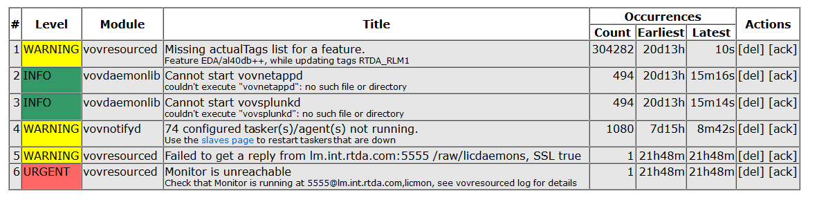

Alerts can be viewed on the browser or the command line interface (CLI). In addition, alerts are stored in log files.
- Acknowledge the alert.
- Delete the alert from view.

Alerts:
URGENT Imminent license violation: us 3 12d20h 12d20h
WARNING License is expiring in less th 2613 12d20h 9d13h
ERROR License is expiring in less th 558 9d13h 8d13h
URGENT License has expired 270 8d13h 8d01h
URGENT License violation 24 8d13h 8d01h
WARNING License violation: too many sl 336 8d13h 8d01h

Some alerts may not require immediate action. However, it is good practice to
acknowledge the alert. The [ack]
link on the alerts page can be
used to indicate that the alert has been acknowledged. The login name of the person
acknowledging the alert will be shown on the Alerts page.
