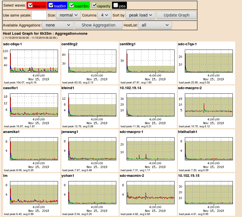

By default, the Tasker Load page shows the reports for all live taskers, one plot for each tasker, as shown below.

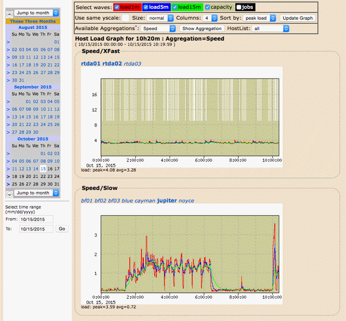

Setting up Aggregation by Speed
Two categories of Speed are available: Fast and Slow. The Fast category includes machine farm01, farm02 farm04 farm07 and farm08. The Slow category includes machine farm12, farm13 and farm14. In this case, choosing to have the report aggregated by Speed will result in two plots: one plot with the sum of the load of the machines defined in Fast category; one plot with the sum of the loads of the Slow machines.
The following is an example of reports that were aggregated with Speed:
