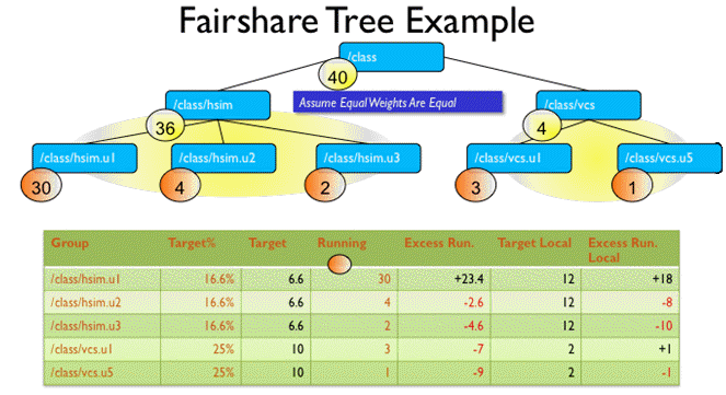

The Special Field FS_EXCESS_RUNNING_LOCAL
The picture below illustrates the difference between the
FS_EXCESS_RUNNING
field and
. While the first considers the total
number of running jobs in the system, the second field only considers the balance of
running jobs at each local level. In the pictures, the nodes of interest are
/class/hsim
and /class/vcs
/class/vcs
has a total of 4 running jobs and 2 children,
with user u1 running 3 jobs and user u5 running 1. Assuming that all weights are the
same in all branches, the target share for /class/vcs.u1
and
/class/vcs.u5
is exactly the same. Looking at the
FS_EXCESS_RUNNING
, it is negative for both nodes because the
node /class/hsim
has a large proportion of the running jobs. In
this scenario, a preemption rule based on FS_EXCESS_RUNNING
as
shown below will not fire:
VovPreemptRule -rulename RuleThatDoesNotFire \
-preempting "JOBCLASS==vcs FS_EXCESS_RUNNING<0" \
-preemptable "JOBCLASS==vcs FS_EXCESS_RUNNING>0 FSRANK9>@FSRANK9@" \
-pool fastfairshare -ruletype FAST_FAIRSHARE
/class/vcs
, it is apparent
that the distribution of jobs is not balanced. To use preemption to speedup the
achievement of balance, the FS_EXCESS_RUNNING_LOCAL
field can be
used as follows:
VovPreemptRule -rulename RuleThatFires \
-preempting "JOBCLASS==vcs FS_EXCESS_RUNNING_LOCAL<0" \
-preemptable "JOBCLASS==vcs FS_EXCESS_RUNNING_LOCAL>0 FSRANK9>@FSRANK9@" \
