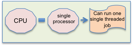

In the beginning, Accelerator only had CPUs, the number of central processing units in a system that are known as "processors" in Linux systems. Initially, each single-threaded job required one CPU. A machine with two CPUs could run two single-threaded jobs.

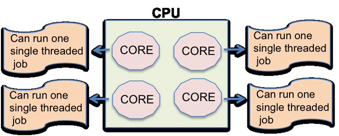

A CPU may contain many cores; the number of single-threaded jobs that can be run on a machine is related to the number of cores not the number of CPUs. The term "CPU" now indicates the "physical package that contains the cores", which is also known as a "socket".

A multi-threaded job takes advantage of multiple cores. To avoid overloading a machine, it is good practice to request the correct number of cores when submitting a job.
% nc run -r CORES/4 RAM/8000 License:abc -- my_4_threaded_job
Because each core can run one job and each job takes one "slot", it is also considered good practice to request the same number of slots as cores. However, this is not critical, as this normally does not impact the scheduling of jobs.
% nc run -r CORES/4 SLOTS/4 RAM/8000 License:abc -- my_4_threaded_job
