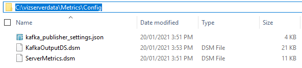

For example, when the generated Kafla data sources are added in the AppData/Metrics/Config folder:
The ID of the new configuration files are displayed in the Publisher drop-down list.
Selecting any of these specific Kafka data sources means that this is only place where metrics will be published to.
