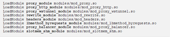

5. Modules are required to be loaded to make the Apache HTTP Server into a load balancer. Add or uncomment the following lines in the httpd.conf file.

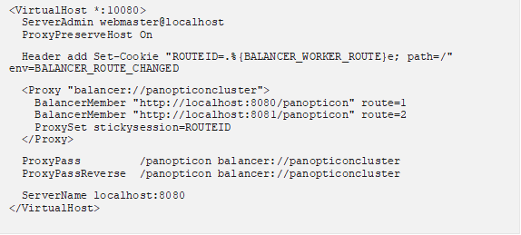

6. Configure the logic for the load balancer and how requests should be passed.
In the following example, we have configured the load balancer to listen to port 10080 and to use two balancer members (Route 1 and Route 2). The example will also set a session cookie named ROUTEID. The cookie contains the route that the user took and will continue to use throughout the active session.
