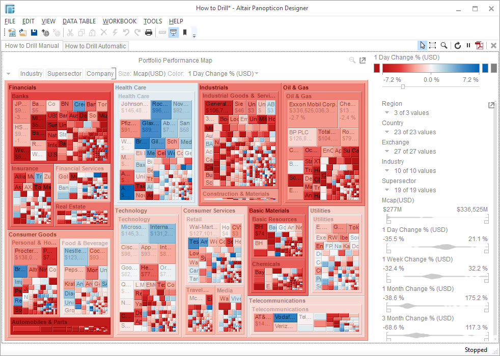

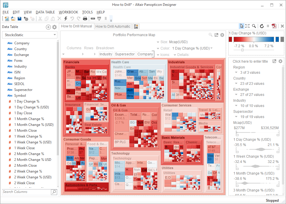

Design Mode
Presentation Mode
Switching from Design Mode to Presentation Mode also removes the design elements from the Workbook display:
