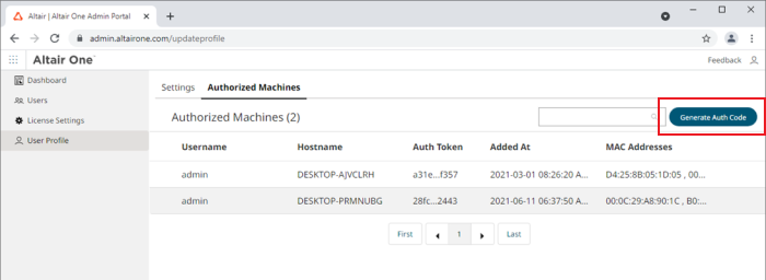

  1. Launch Google Chrome and then go to the Altair One Admin Portal at https://admin.altairone.com. Log in with your credentials.
  2. Once logged in to the portal, navigate to User Profile > Authorized Machines.
  3.
  4. Click Generate Auth Code.
  5.
    The page refreshes to display the authorization code and a countdown of time left for authorization.
