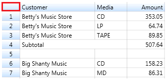

Selecting the entire table - To select the entire table, select the top left cell on the table:
