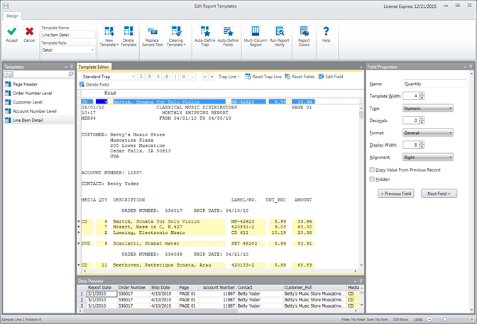

To extract fields from a report, you must begin by defining a detail template. A detail template extracts fields from the lowest sort level in the report, referred to as the detail level (also known as the transaction level or itemized level). The detail level contains the data that changes most often in the report. Monarch Classic generates one database record for each detail line extracted from the report.
In addition, you can define templates for the higher sort levels, called append templates. An append template adds, or appends, information from higher sort levels to each record extracted from the detail level. If append templates are necessary, they can be created in any order. You may define up to twenty append/footer templates to extract data from higher sort levels, plus a page header template to extract page header data and a footer template to extract footer information, such as totals.
Assembly of database record from a detail template and append templates.
Fields extracted using an append template are associated with the detail record if the append level begins anywhere on or before the first detail line. The extracted field values are appended to all subsequent detail records until the next occurrence of the append field in the report. For example, in the illustration above, a separate detail record is created for each transaction. The customer name, contact and ship date fields, which are extracted using append templates, are associated with all four records.

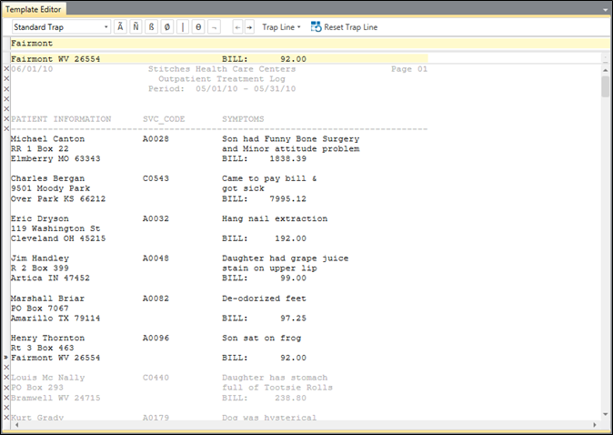

EXCLUSION TEMPLATES
Exclusion templates are used to specify lines or parts of lines that you do not wish to be captured by a detail, append, header, or footer template.
In the figure above, for example, the red line marks an exclusion template. This template will allow the order number and ship date of every record to be captured even if a colon is used to trap these details.

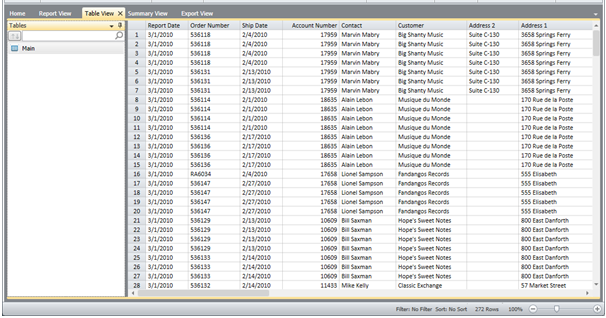

When Monarch Classic extracts data from a report, the data is placed in a database table that you can view and manipulate in Table View. The database table is comprised of rows and columns of data, with each row representing a database record and each column representing a field.
Monarch Classic assembles records automatically as you define detail and append templates in Report Design. Fields from the detail template serve as the nucleus for each record. Fields extracted by the append, page header and group footer templates are appended to each record.
Each detail line from the report produces a record in the table.
While creating your template, you can get a preview of what data is extracted by viewing a subset of the records in Report Design's Data Preview panel.
The Data Preview panel provides a preview of how data will be extracted.
