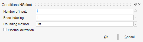

Name | Label | Description | Data Type | Valid Values |
nin | Number of inputs | Number of inputs to be copied to output. | Number | |
base | Base indexing | When 0 is selected, the index counts from 0, the 2nd input is labled case 0. When 1 is selected, the index counts from 1. | Scalar | 0 |
rule | Rounding method | Method for rounding the control signal to an integer, when the control signal is a non-integer. | String | 'int' |
add_default | Add default input port | If selected a default input port is added. In this case, if the control does not match any of inputs, the default input is used. | Number | 0 |
externalActivation | External activation | Specifies whether the block receives an external activation or inherits its activation through its regular input ports. When External Activation is selected, an additional activation port is added to the block. By default, external activation is not selected. | Number | 0 |
