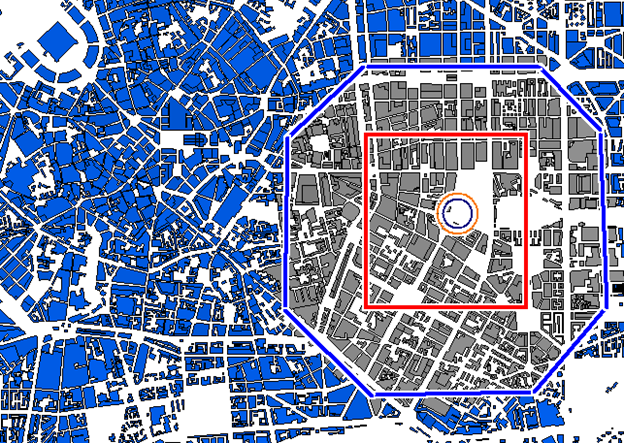

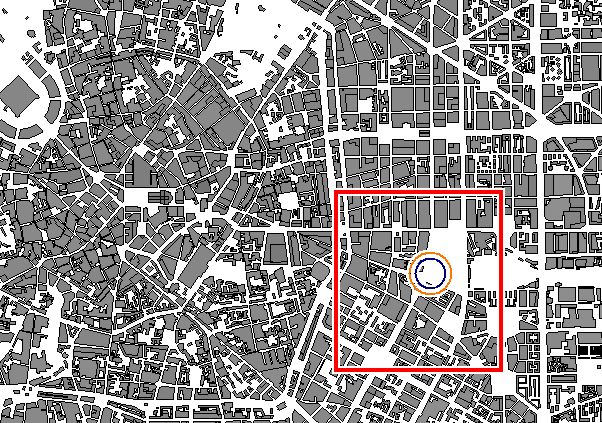

For large databases, computation time can be reduced by defining database areas where ray interactions are tracked.

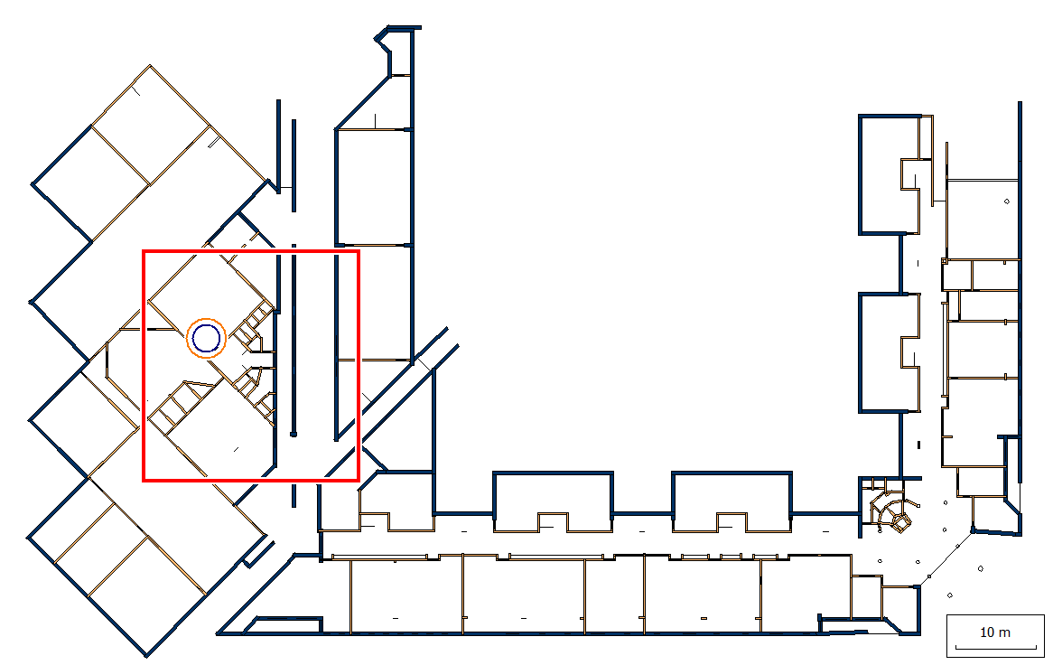

Figure 1. Example of a prediction area that is small relative to the database.
Figure 2. Example of a prediction area that is small relative to the database.
Even then, depending on the simulation method, simulation times can be long because the tool still investigates how interactions of rays with all buildings (including those far away) affect the results in the prediction area. To reduce the simulation time further, you can define a polygon that describes which database area is to be included in the tracking of the ray interactions.

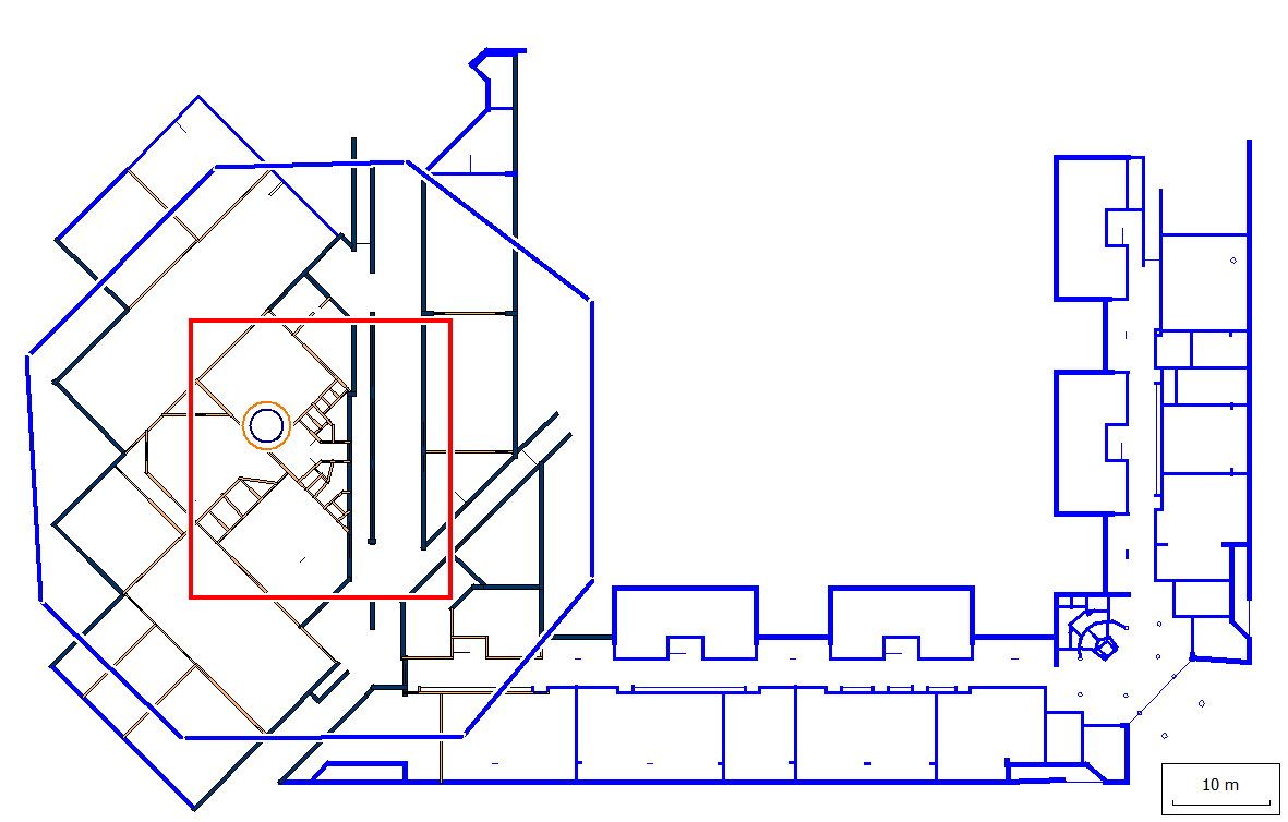

Figure 3. The database area is indicated by the blue polygon. Ray tracking is limited to inside the polygon.
Figure 4. The database area is indicated by the blue polygon. Ray tracking is limited to inside the polygon.

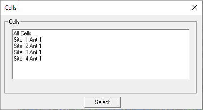

Figure 5. The Cells dialog.

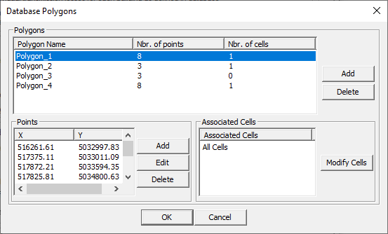

To manage all the database areas open the Database Polygons dialog. Click . Select the Database tab and under Database Polygons, select the Consider database polygons check box and click Settings to launch the Database Polygons dialog..
To manage all the database areas open the Database Polygons dialog. Click . Select the Building Data tab and under Database Polygons, select the Consider database polygons check box and click Settings to launch the Database Polygons dialog.
Figure 6. The Database Polygons dialog.
- Add a new polygon.
- Delete an existing polygon.
- Add a new point to a polygon. The position of the point can be specified by selecting one of the existing points (the position will be next the selected point), if no position was specified the point will be added to the end of the points list.
- Edit an existing point.
- Delete an existing point.
- When adding, editing, or deleting a point, some checks are performed if the polygon is still valid (does not intersect itself and it has at least three points).
- Modify the assigned transmitters to this polygon.
- If a cell does not have a polygon, the whole database is considered as usual.
- If a cell has one or more polygons, the objects that are inside any one of the polygons are considered while the remaining objects are ignored.

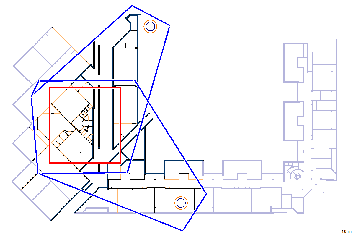

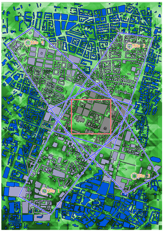

If you have multiple transmitters and a modest prediction area between them, defining database areas (see Figure 5Figure 5) can be efficient. The prediction area (the red rectangle where results is computed) is part of all database areas, and each individual database area also includes the buildings between the transmitter and the prediction area.
- The objects, which are ignored by all transmitters, are considered as virtual objects and are represented in blue.
- The objects, which are considered by all the transmitters, are represented by its default color.
- The objects, which are considered by one ore more transmitters and ignored by other transmitters, are considered as partially virtual and are represented in light blue.
Figure 7. An example showing multiple defined database areas.
Figure 8. An example showing multiple defined database areas.
