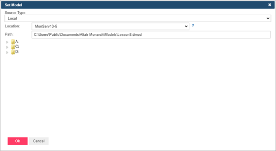

1.     On the Model and Verifications tab of the Project Editor, click the Browse button next to the Location field to select the desired model.
2.     In the displayed window, from the data source type drop-down list, select Local.
3.     In the Location field, select the location type.
NOTES
If the required server is not on the list, you need to create it. For information about adding a new location, refer to the Locations Management topic in the web help.
In case of a single server configuration, refer to Monarch Server Configurator Guide to change location settings.
4.     In the Path field, enter the file path of your target model, e.g., C:\Users\Public\Documents\Altair Monarch\Models\Lesson8.dmod.
5.     Click OK. The model file path is displayed in the Location text field.
