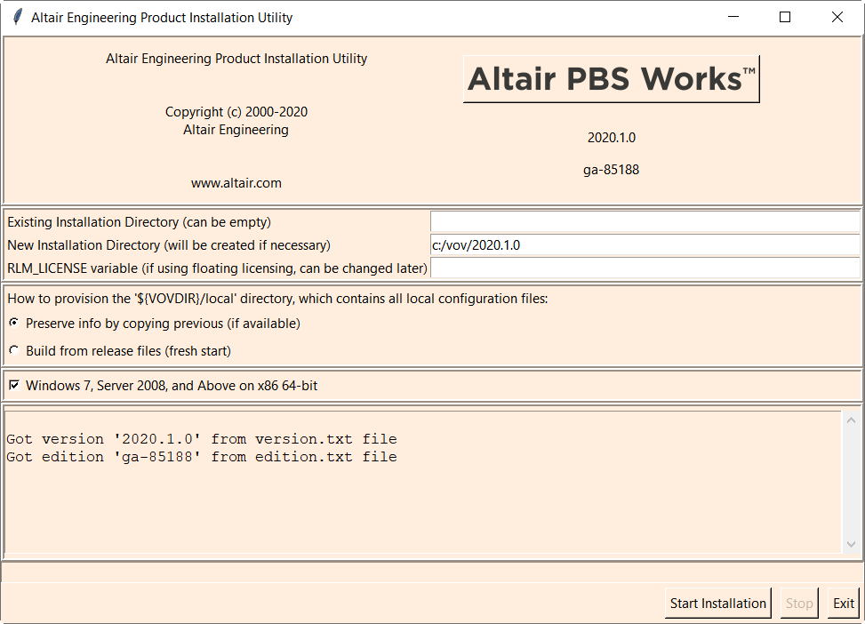

    The installation dialog appears. The first field shows the path to the current release if one exists. This should be empty because this is the first time Altair Accelerator products have been installed.
  2. In the New Installation Directory field, enter the full path to the desired location.
    The new installation directory can be created automatically , if necessary.
  3. Set the RLM_LICENSE variable field to the license server location.
    The value of RLM_LICENSE can be specified in one of two formats:
    • As port@host (recommended): <port>@<host>
    • As a full path to the license file:
      <absolutepath>/<rlm_license_file>
    Two example values:
    7070@licsrv
    /remote/opt/rtda/local/rtda.lic
    If left blank, the RLM_LICENSE variable will be assigned the default value of $VOVDIR/local/license.rlm.
  4. In the Local Directory Option, select Build from release files (fresh start).
    This tells the installer to make new files within the common/local directory and to initialize them with files from within the baseline release.

  6. Click Start installation to start the installation. It normally takes a few minutes to run, depending mostly on the speed of your disk.
    During the install, the program will write messages into the bottom section of the dialog, which is a scrollable region. The messages are also written to a log file on disk in the new installation directory, named install<timestamp>.log.
  7. When the installation is done, click Exit.
